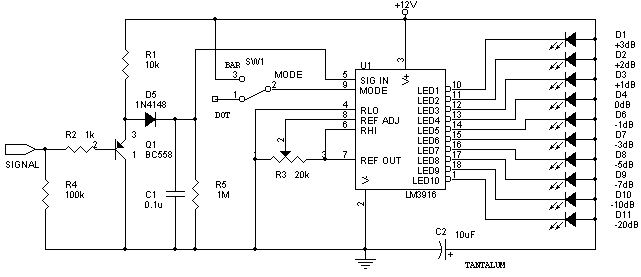

I don't know if I'm inclined enough yet to go this route, but I may build an audio level meter with a potentiometer to trim the actual input level.
![](/forum/proxy.php?image=http%3A%2F%2Fwiredworld.tripod.com%2Ftronics%2Faudio_level_ckt.png&hash=faaac9429bde573d0cb7835ebf2082d4)
