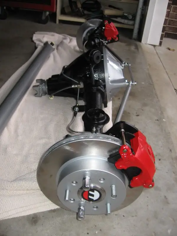

Yea i wanted to do something like Todd's. Wasn't sure how the solid line to the caliper would work. I had the line on the frame and 2 flex lines to calipers before but want to eliminate one flex line. Got my bracket on the housing and painted it up yesterday.
does it matter which side the caliper is on?either the differential cover side or the yoke side?mine is on the yoke side because they are LS1 disc brakes
