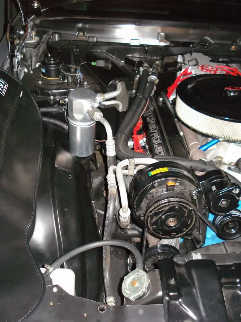

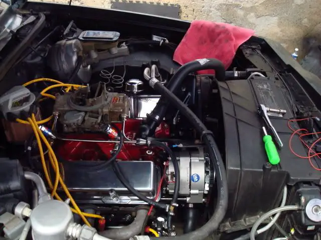

i'm working on an 86 regal originally a v6 n/a car and now it has a small block chevy. i took a whole hvac system out of an 87/88 monte carlo v8 car. so far i have the blower motor working.
what is this thing and do i need it?

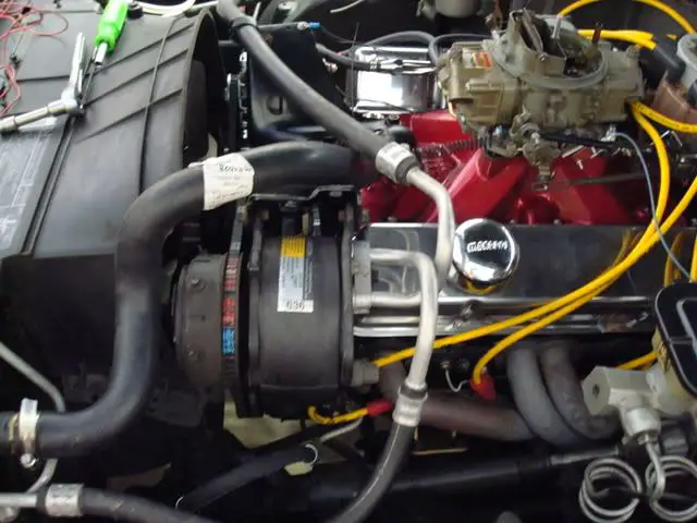

i'm also worried that i don't have enough brackets on the compressor. i have two on right now
i'm pretty sure i have the wiring completed inside the car. just need to wire up the compressor now and i'm not sure what else. any guidance would be greatly apreciated. thanks!!

As far as i know this connector on is all you really need. The heavy red wire needs to go to +12 volts to run your fan on high. The two green wires go to the compressor. The other end of this connector is on your inner fender well in your last pic, along with the grey color vac. hose. This vac. hose should go to manifold vac. Did you get the valve that goes inline with your heater hose?
I'm working on my a/c as well. Tring to get everything together since i went to a serp. set-up

damn that looks good. ok so to work my fan on high i need to put that plug on. or at least run a red wire for it. where does the other end of the red wire go? yes i do have the valve on the heater core line now. how do i include the vacuum ball into the mix? right now i can't get air to blow out of the vents. i have the purple line going to manifold vacuum and the grey line on the vavle.

No you need to plug the end i showed you first here.
Then on the other end ( in the first pic i circled ) find the red wire that you cut, that needs to go to +12.
On my set-up which could be a different year than yours, my grey goes to manifold vac. and the purple goes to the valve inline with the heater hoses. I spent last sunday with a vac. pump and a DVOM testing all my a/c components.
