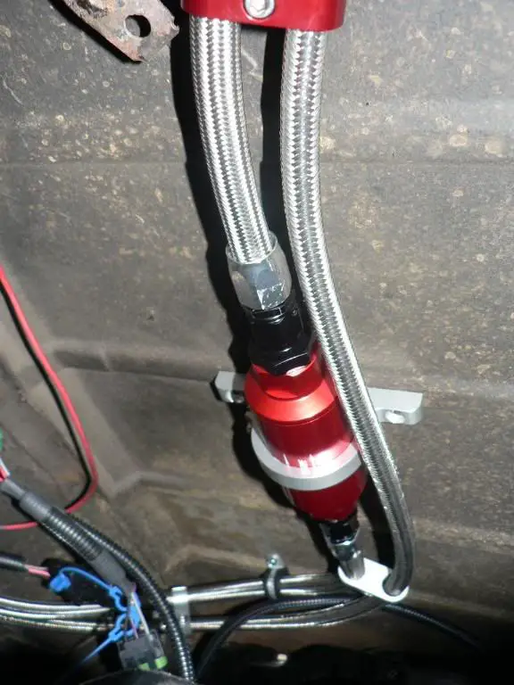

Where did you get the elbow for the air intake?
Do you have the fuel rail that has a return line built in, or how did you run a return line?

Fuel rails---Well i use to have Typhoon so i installed EFI V6 Monte Tank with sender then hook 18an to the fitting on sender and compression fitting on the return line with -6an return line and used aeromotive press reg on back of fuel rail with -6an line on the bottom for the return line.
