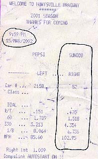

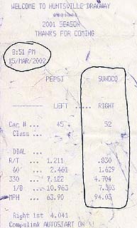

PERFORMANCE:
NEW BEST
ET'S! (3/15/2002)
Best 1/8 Mile (motor only):
[email protected] MPH ENGINE SPECS: The engine is a 2 bolt
