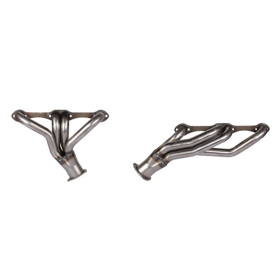

not many headers fit with a stick :( Try Speedwaymotors.com
