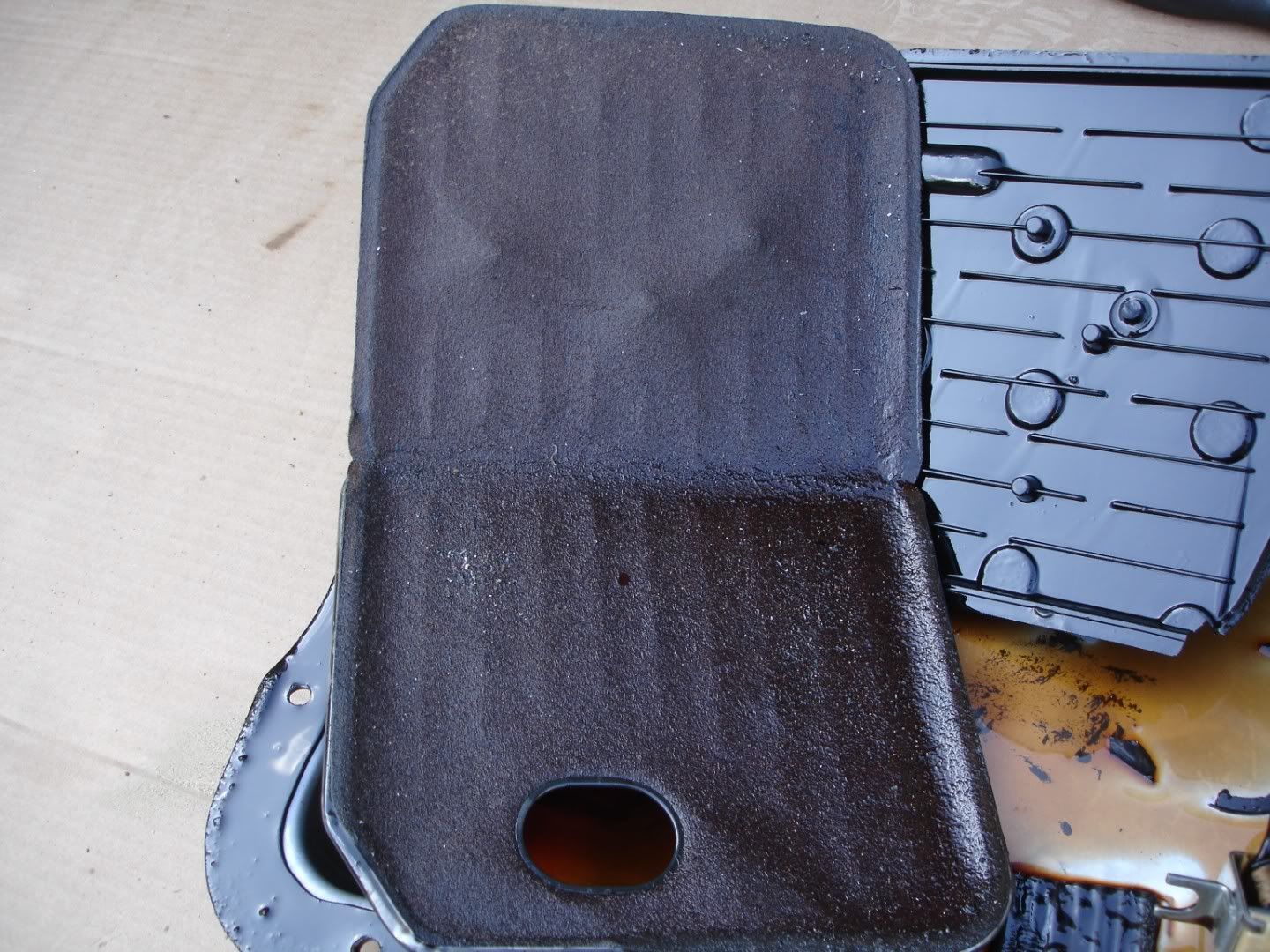

So everything's apart... I took the solenoid/harness out, and it seems to be working, I just have to tap on it for it to open back up (not sure if that's normal with it outside the trans). On the up side the filter didn't look too bad, there was a very little bit of material, but nothing to be worried about yet... I don't know how long it's been since the oil/filter/magnet's been changed, but the fluid is a bit dark, I'm thinking a trans flush may be in order, but I'm pretty sure they're quite expensive.

getimage.php
Here's the filter... Truck has 216,000 miles on it.
