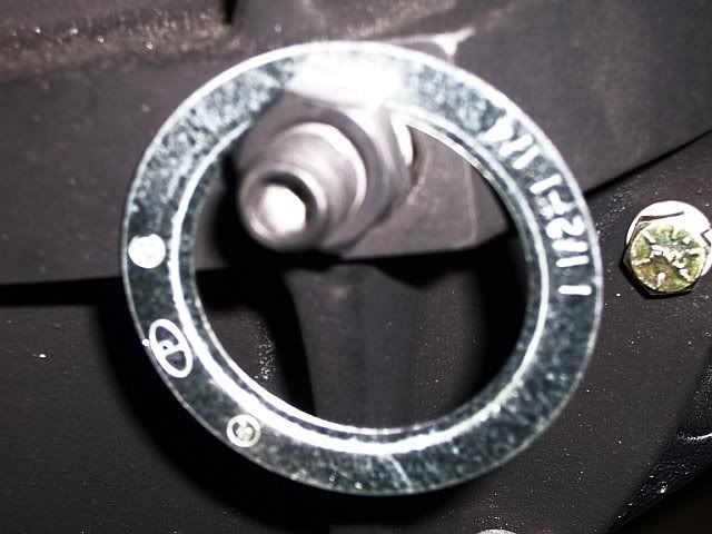

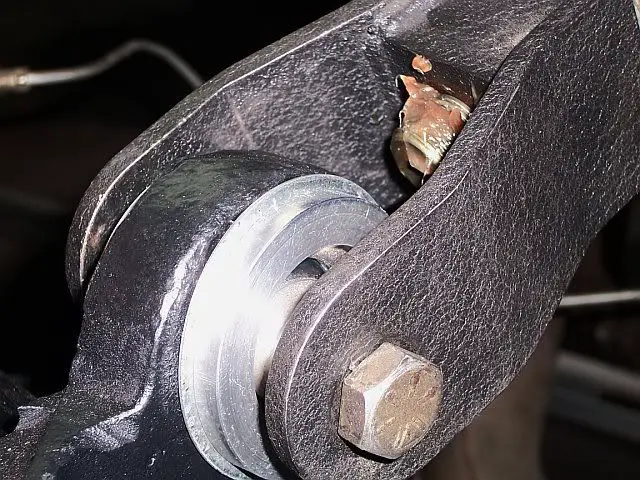

I did have one small issue with the TRZ bushing, it was still ever so slightly loose when installed.
Could be I just got a thinner casting knowing GM tolerances.
Walked around Home Depot with the bushing trying to fine something with the right I.D.
I think this was a Rigid Electric box fitting, my rear is now UL approved! :lol:
I did have to clearance the ID with a grinder (2 minutes), installed one on either side. Looks kinda trick!
