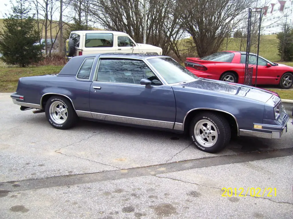

Does anyone have any info on installing a manual trans in a 84 Olds Cutlass?Have all the parts,just no instructions,the company we got the pedal and z-bar assembly from has no info on the installation !I've replaced pedal assemblies before,just never a conversion like this,mainly need to know where the clutch rod comes threw the firewall,is there a knock out plate in the firewall for this? any pics or info would be awesome,The car is a 3.8L v-6 350 turbo auto right now,but installing a 350 Chevy and a Munsie M-20 4 speed into it!I know alot of Bu's came with a stick,but not sure about the Olds,But still the same in retrospecks!Thank's in advance for any info or HELP!this is the Cutlass I'll be installing the parts in!
