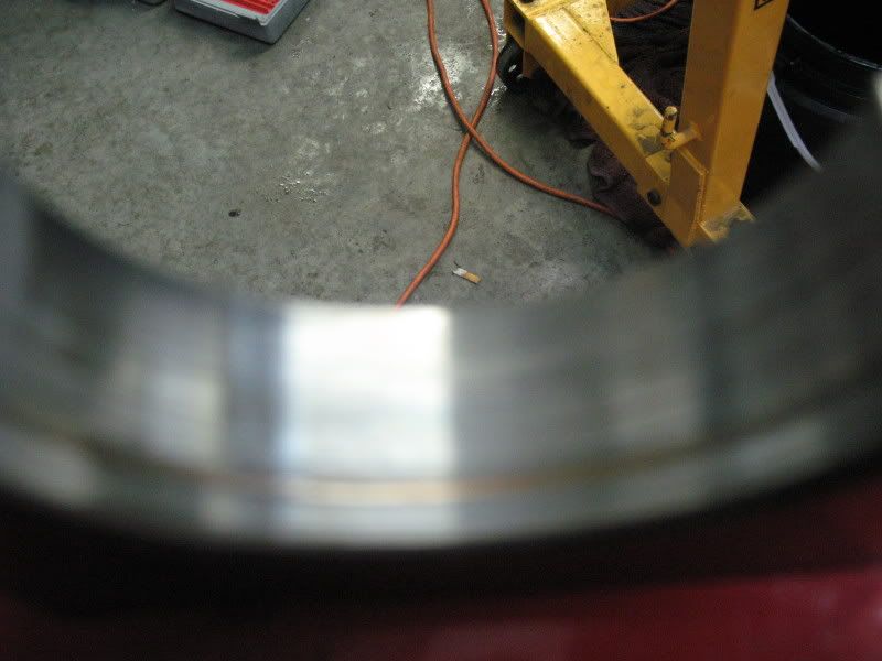

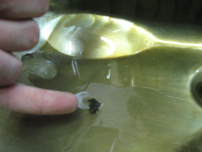

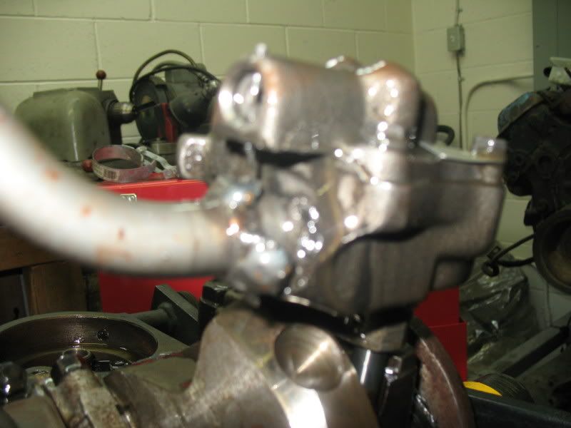

pulled the heads first and found some grooves in the cylinder walls, then we pulled off the pan and found that the oil pump was laying in the bottem of the pan with metal chunks blocking the oil pickup filter, we found that there was chunks of metal debris in the pan., we pulled off the mains and all the bearings were wiped out, and so were most of the rod bearings.
shitty thing is i payed alot of money to build this motor, and i never drove it, the block needs to be machined again, and the crack needs to be polished, maybe turned too, need all new bearings, rings, oil pickup, and the list goes on. looks like i wont make it to the track untill mid season.
oil pick up after i place it back in place, notice the nice welds

debris i found in the pan
