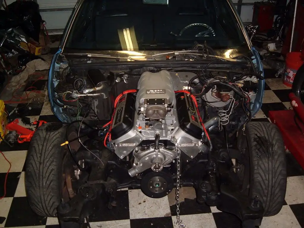

There are a few of us here on the forum that have done BBC swaps. Heres a pic of one of mine during the instal...
i got a big block in my car. check my signature for details.
do all the power steering brackets and things stay in the same place? and i noticed garyg that you did not have to cut into the air conditioning unit...? i think my valve cover is going to be digging into that piece..?thanks for the help guys....
