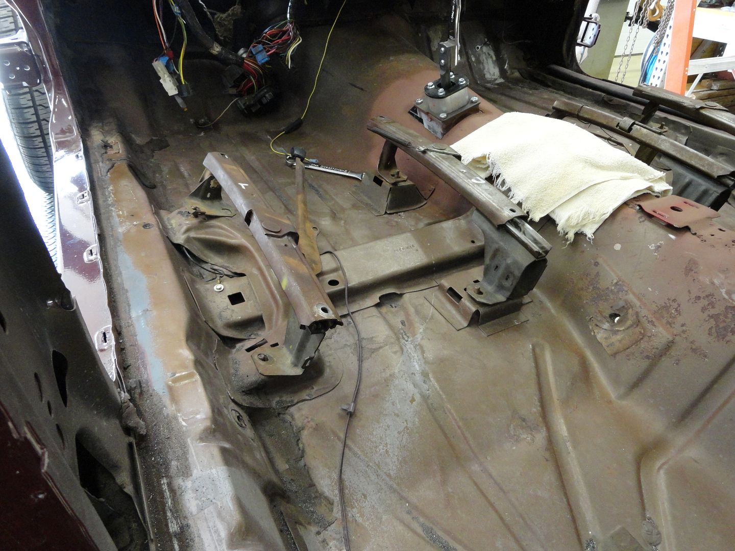

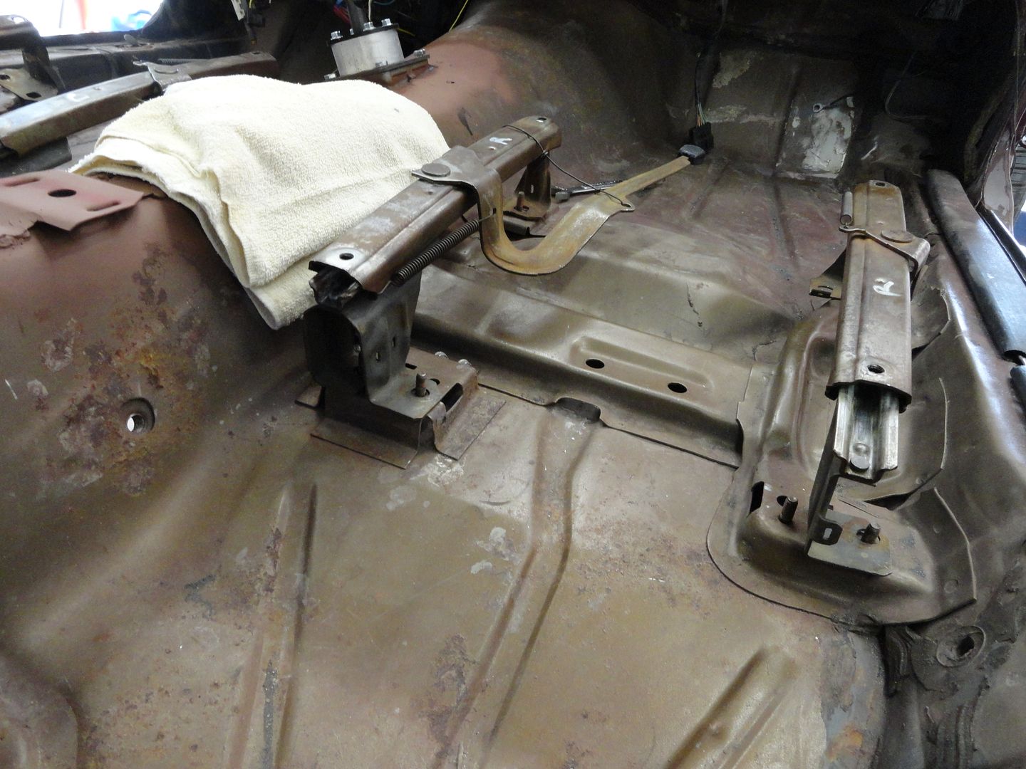

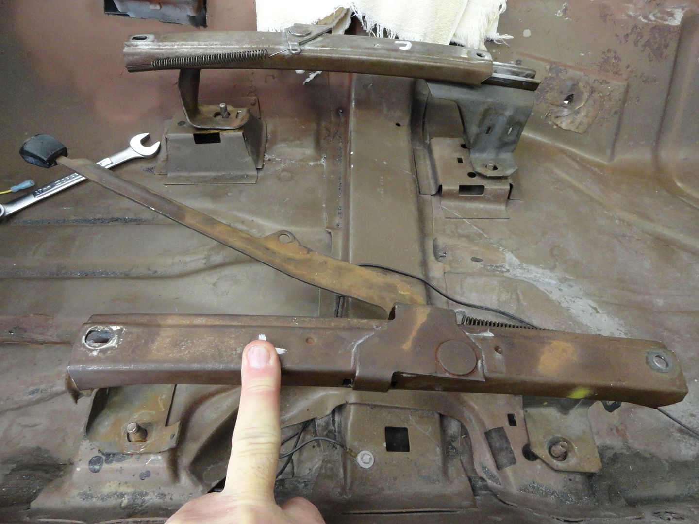

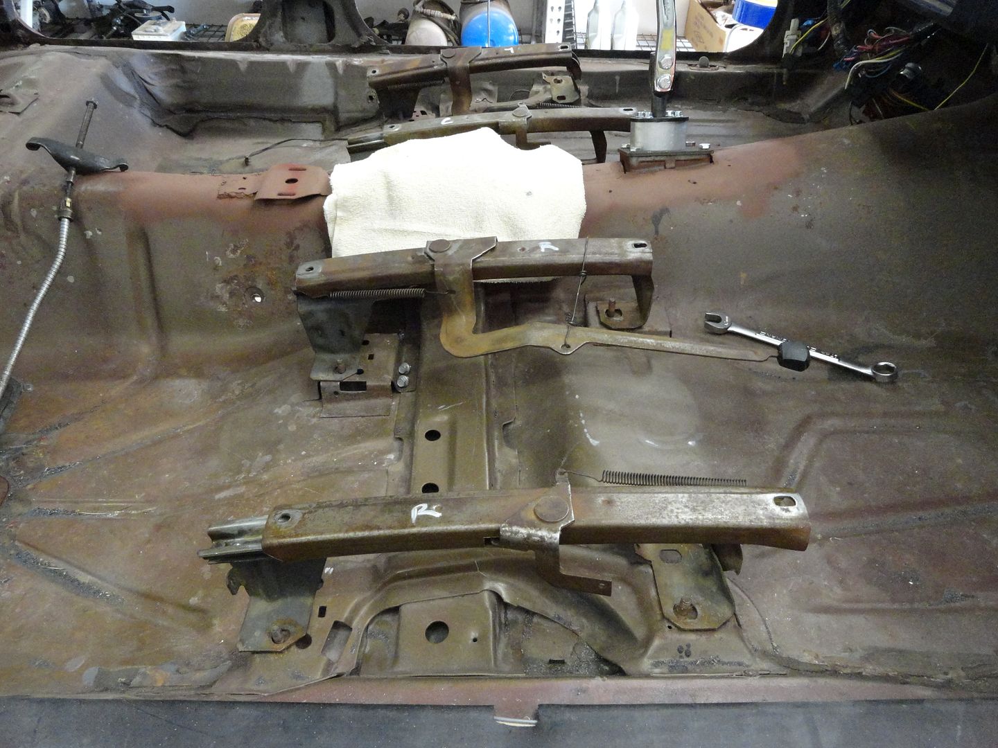

DWR, your description makes it much easier for someone looking for the answer. I searched the parts catalog and service manual to get my answer but hopefully the photos help this along for future reference. …
This is the Left Side (Driver)
Left Side
This is the Right Side (Passenger
Right Side
