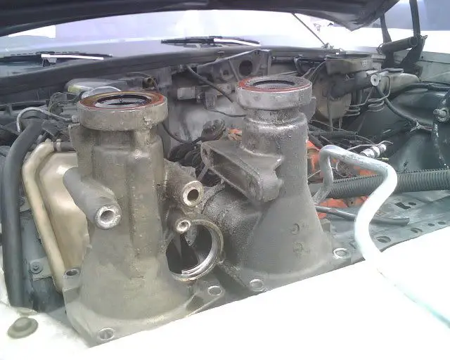

383S10
Feb 29, 2004
581
Huntsville, AL
I have a 88 Corvette 700r4 in car and all I had to do was get the tailhousing on the right in the picture they came on Caprices of the same year and later. The housing you have was used on Corvettes and Camaros but the other piece was was needed for the Caprices to mount the 700r4 curiously never have checked the same trucks that use the 700r4....the only thing you have to remember is that when use this piece the mounting length of the 700r4 will be the same as 200r4 and TH400 and wont have to tear down the trans to make it work....you should notice that there are no mounts at the rear of your 700r4 case the were on the tailhousing at least mine where ..
