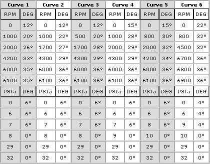

On the carbed Ls1 'package' you buy from edelbrock it comes with a timing control and 6 pills. Does anyone know the specifications on each pill. I saw a chart once but cant find it anywhere. Im pretty sure they all peak out at 34* timing at WOT but i know they are all different at part throttle.
