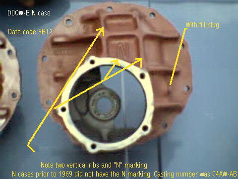

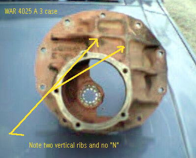

The 57 is a War case. It was used from 1957 to 1964, and has the extra rib on it.
I am not a fan of them, but some people like them.
If the others have an N on the center section That is a good start.
The WAR case may have an N on it but it is not Nodular
