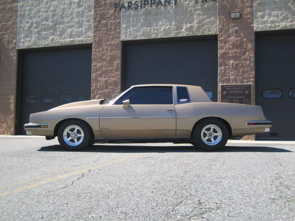

I'm trying to decide between V6 springs (moog 5596) or moroso trick springs. This will be in a 81 GP which should be running high 11's (maybe mid 11's in forseeable future). I'll be using 90/10 shocks in front.
I know this question has been asked before and there seems to be plenty of people experienced with either or both. However, I'm still not sure what would be best for my application.
I do not know the exact weight of the front of the car right now. It is pretty close to stock. It is a sbc with dart iron heads but a few other typical aluminum bolt ons. It's been a bit of diet in the front but relatively minimal weight loss. Total weight is 3400.
From what I've read some people have had bad experiences with the trick springs (sagging, ride height, etc). One could argue this has only been because they chose the wrong spring rating. However, I've read they can be a real pain to install on G-bodies so putting them in and out a couple times if I need to cut a coil or two does not seem like fun. I have read no specific complaints about the v6 springs.
