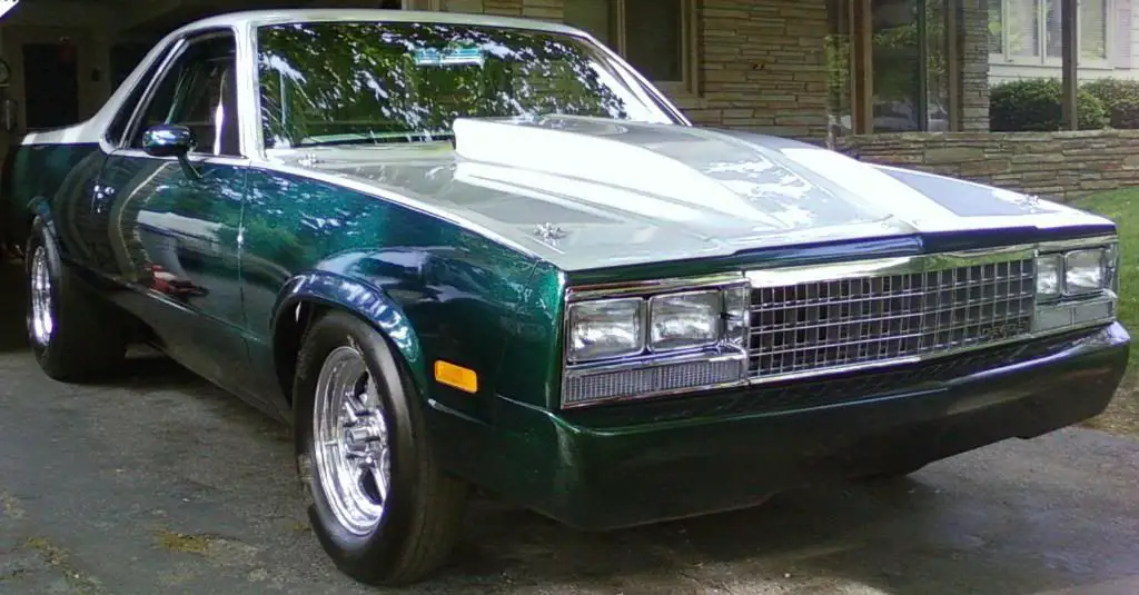

elcoholic
Feb 4, 2008
152
Omaha, NE
is this the kind of bumper you're talking about? this one is a tucked bumper from lauren eng....not sure how close it is to the harwood...I can take some pics of how it's mounted if you need....
