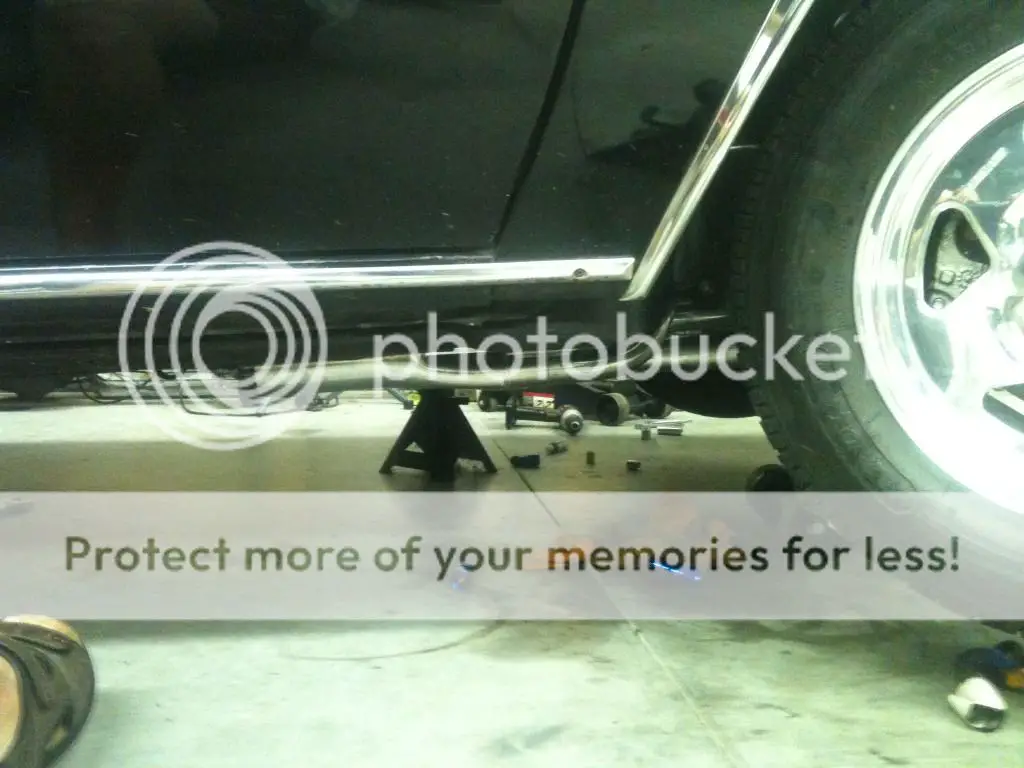

i wanted a 1-7/8 primary and was looking at the brp ones. i see in some pictures they hang down very low....not sure what other options are out there.

Did u not see my thread? Check the gallary for pics of my car as it sits. I will take some pics of the collectors sun for u anyway..

is this the thread?
http://www.maliburacing.com/forum/viewtopic.php?f=14&t=113621
mainly looking to see how low they hang down....the bottom of my pan is just about the bottom of the crossmember of the frame

hope this helps..
