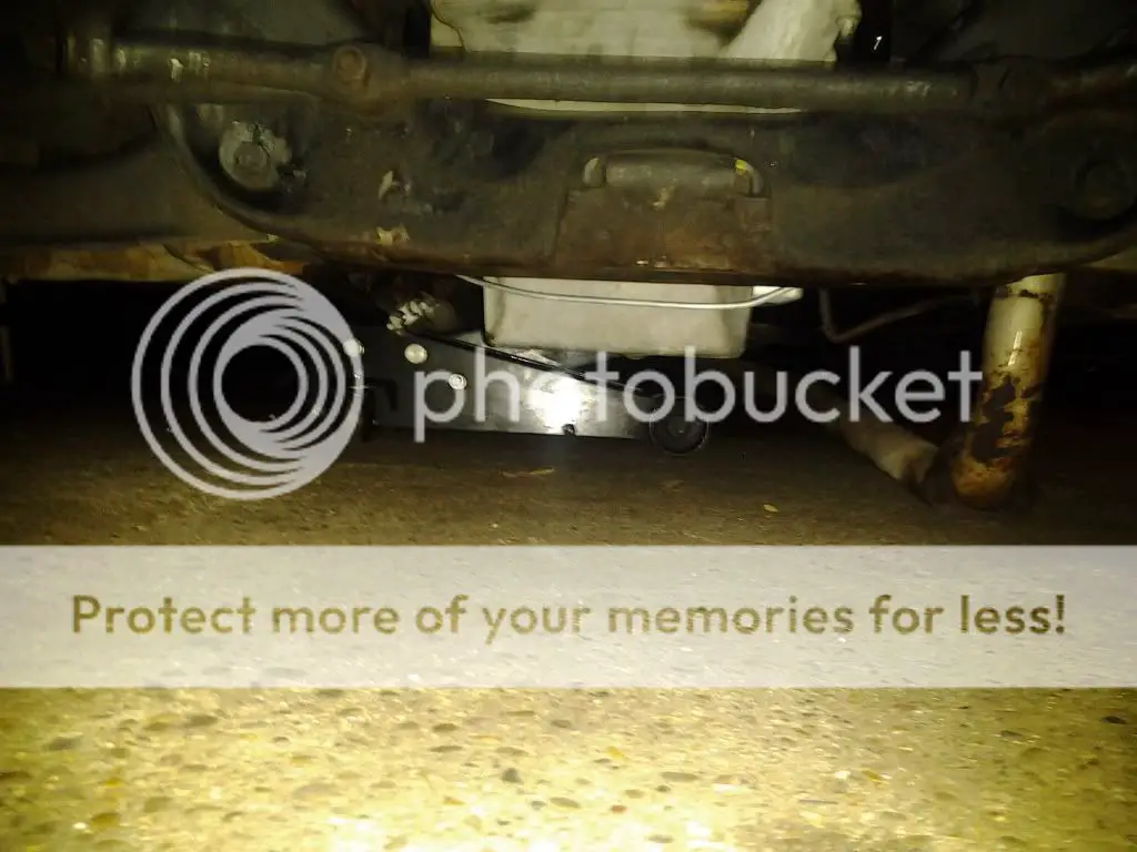

The truck pan hangs this low...

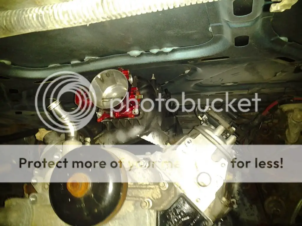

The truck intake sits this high....
My car has v6 springs and the pan hits the ground....
