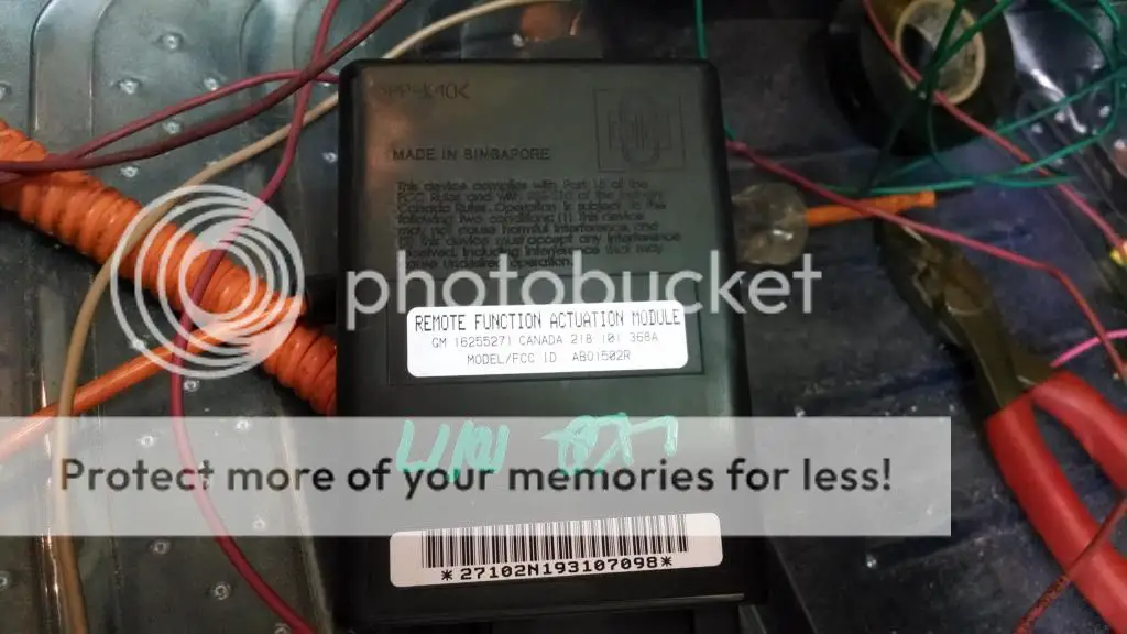

1. Locate a donor car with RKE. The RPO code on the SPID label on the underside of the trunk is AU0. The module is INSIDE the car just to the right of the right rear speaker UNDER the package tray carpet. It's attached with Velcro so just pull it off. Disconnect the connector and push it into the trunk.

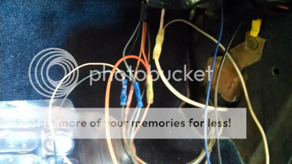

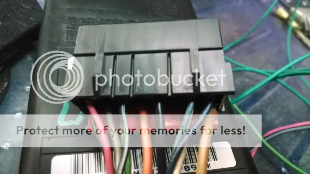

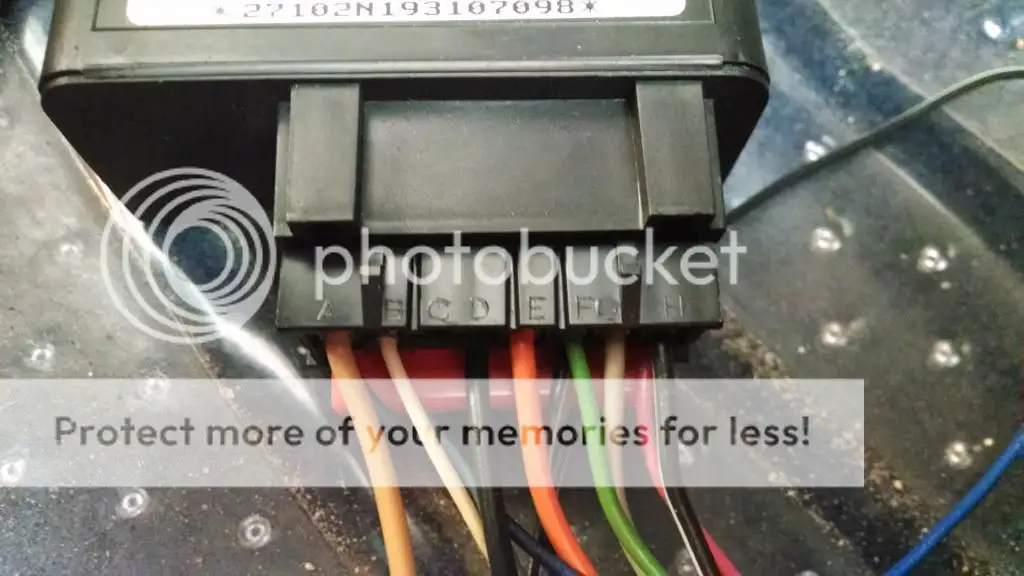

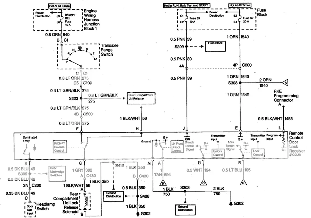

1. Almost every connection can be made at the Right Front kick panel where the door lock relay is located. I spliced my wires with butt connectors because I hate a Scotch Lock. If you look close at the module connector, you will see letters that label the cavities in the connector. I'll list them by letter, color, function, where to splice (SP-)
A. Tan, not used (I'll explain why later)
B. White, unlock control to relay, SP- Black wire on Lock relay
C. none
D. none
E. Orange, Batt +, SP- Orange/Black wire on Lock relay
F. Light Green, Trunk release, SP- Pink wire on trunk switch
G. Gray, Trunk release, SP- Black wire on switch
H. Black/White, not used
J. Pink, Switched IGN voltage, Run to fuse block to a Switched IGN source
K. none
L. Black/White (smaller gauge than H), programming connector
M. none
N. Black, Ground, add ring terminal and ground under screw for relay
P. none
R. Light Blue, lock control to relay, SP- Light Blue wire on Lock relay
S. Dark Blue, Illuminated entry (interior lamp control), SP- White wire from door jamb switch
Your colors should be the same except for maybe the trunk release. Mine was an add-on but check your power at the switch with a test light. F is power into the module and G is power to the trunk Solenoid.

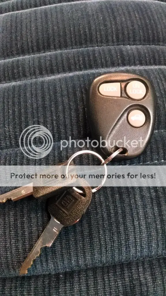

3. Locate your remote. Part numbers: 16245103, 16207901, 16207903 are listed as correct for the module I used. There may be others. With the programming connector still grounded, hold down LOCK and UNLOCK until the locks cycle again (may take up to 30 sec). Do this for all the remotes you want to add (one after another, up to 4). Remove the ground and test.
One press of the UNLOCK should turn on the interior lights. A second press should unlock all doors. The LOCK and TRUNK functions should be pretty straight forward. The TAN wire we didnt use is for cars where the Left front door is wired separate from the others. This would allow for the first press to just unlock the Left front door and turn on the lights. I didnt want to cut more wires and run them elsewhere so one press works the lights only.

Mess of Wires by Relay:
Module

Connector Pics:
Wiring Diagrams:
Malibu
Lumina

Someone told me about a similar thread over on the Monte Carlo site. I checked it out and we both had the same idea. To give jman093 credit, I went back and used his pics to help locate the placement of the Tan splice. That wire that should control the unlock on the first button press but I didn't dig far enough. Turns out the splice is actually in the connector for the harness that goes into the passenger door. Mine was tucked down in the body of the kick panel. After digging it out and cutting out the wire for the left door, there was only one extra wire to connect to the module. Now the left door unlocks on the first press. ...Never to old to learn something.
