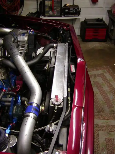

Heres a picture installed in my Malibu.It moves the radiator 3-4" forward,plenty of room for my procharger,vacuum pump.So you should be able to fit a turbo.
blownbigblock: hood pin springs? why didn't I think of that... where did you get them?
You still have room and mountability of your A/C condensor? And what about those steel braided lines for it... Where did you get them... them is slick?
Was the radiator support hard to put in? Any extra fab work?
The hood springs came from Tractor supply.The one I picked was to long so cut it in half and made 2.The SS hose is my transmission coolant lines.I had them made at a supply house that sell hydraulic hoses and no AC no room for creature comforts. Art
