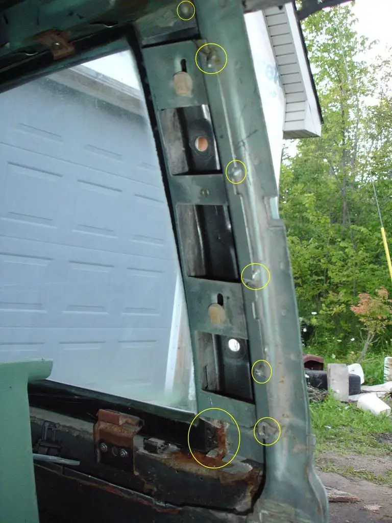

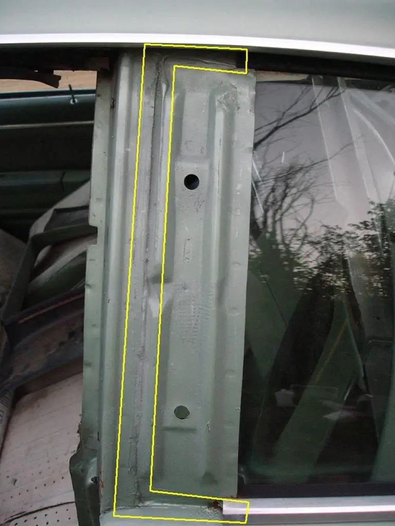

MalibuMan1979 said:
ok, doob. tell me you just drill out the spot welds and separate the metal over lap on the outside. replace the glass and interior/outside trim. tell me that it is that easy. please....
Yes sir
