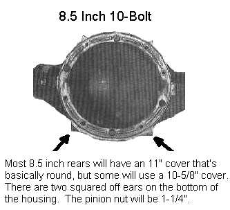

Montes never had an 8.5, a lot of people seem to think this. Only T-Type Regals/GNs, and I believe 442s had them.
8.5" (note squared corners at the bottom)

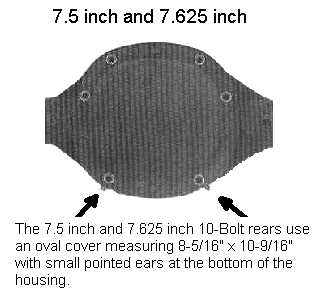

7.5" (note "fingers" at the bottom)

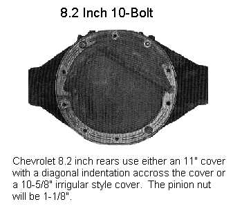

Chevy 8.2" (note ridge stamped into the cover, no corners or "fingers")

If it's out of a completely stock 78+ Elky, it's a 7.5".

I would bet it all on 7.5 for sure.
If you post a picture of the rear cover will ID it for you real quick. Jim
