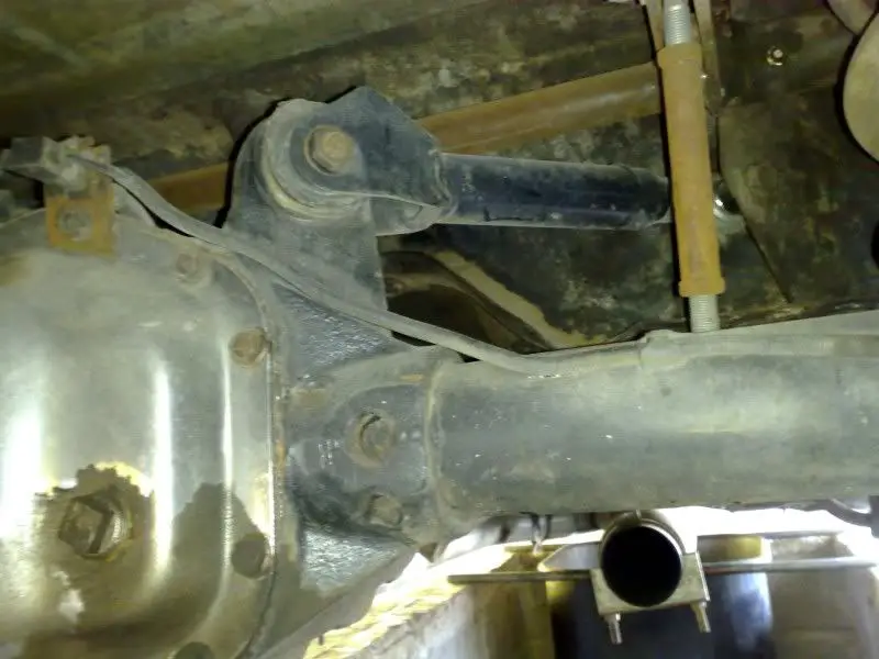

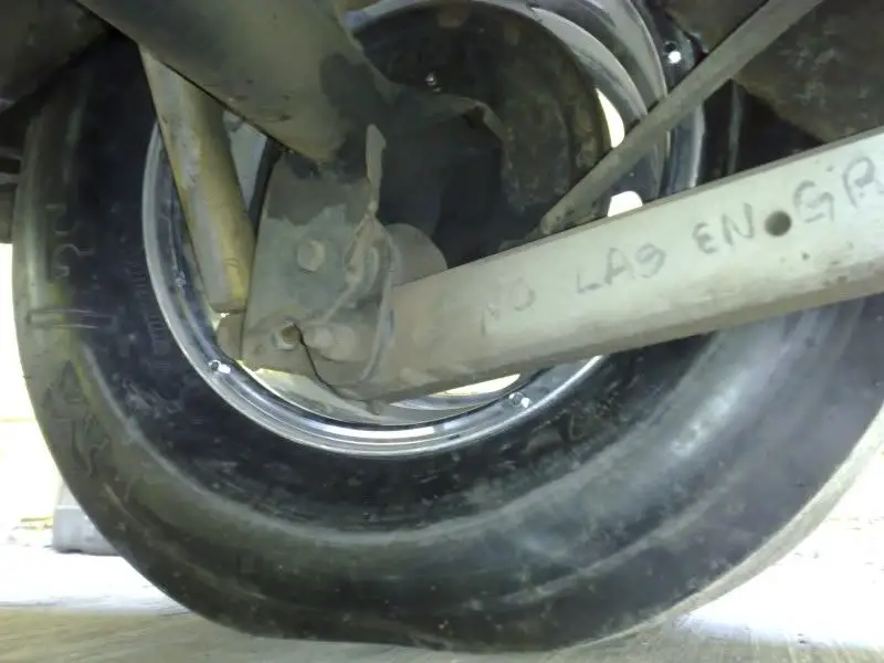

Hi guys I need your help with my suspension, i never had traction problems with my set up with footbrake but now we installed another th350 with transbrake and a bigger converter and the tires spins very hard, I tried to launch at 4500, 4000, 3500 with the same problem
this is my setup , i was using M/T 28x9 slicks on 8'' wheels, metco lower trailing arms with the relocation bracket, jegster uppers and antirollbar.
At the front i have moroso drag springs and qa1 single adj shocks
At this time we already notch the frame and i put 15x10 wheels on 28x10.5 m/t slicks

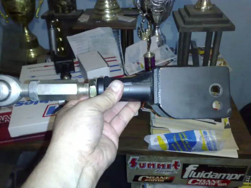

I have been reading here at several post that is better to have the lower arms parallel to the ground so i already removed the relocation brackets and i bought this upper arms from 5 door but i'm wondering what hole to use to install them at the rearend mount after the relocation bracket was removed.
any advice about it would be apreciated.
