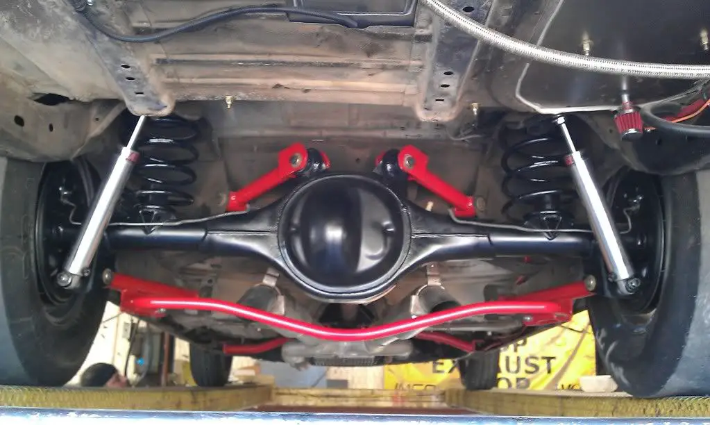

Purcell Racing
Jun 10, 2011
71
Mineral Wells, Texas
tubage said:
Purcell Racing said:
I run the QP nine inch and I've never had any problems. Bolted up fine and no leaks
Can you still run a factory type rear sway bar?
How about the lower shock mount alignment?
Yes sir. Sway bar still worked and the shocks still mounted up in the correct place. Here's a pic for u all to c
