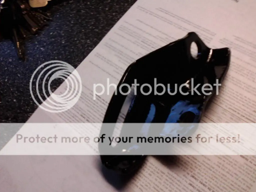

i actually modified that big a/c- p/s bracket to just hold the ps pump.i widdled it down pretty small to just attach to the front header bolt aided by a spacer and it allows full adjustment of the pump.I'm not using it anymore i switched to serpentine set up but i could take a picture if you'd like so you could see what I'm talking about.

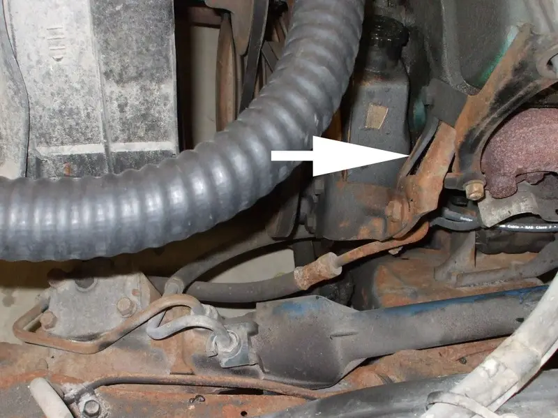

There is the factory bracket:
....most people forget to take this piece when removing the AC delete set-up from a donor car. Most any GM vehicle with a small block/no-AC/pwr. steering has this same bracket.
If you need/want a picture of just the bracket.......lmk.

here's mine that i used with a stud and a spacer off the front exhaust bolt.
