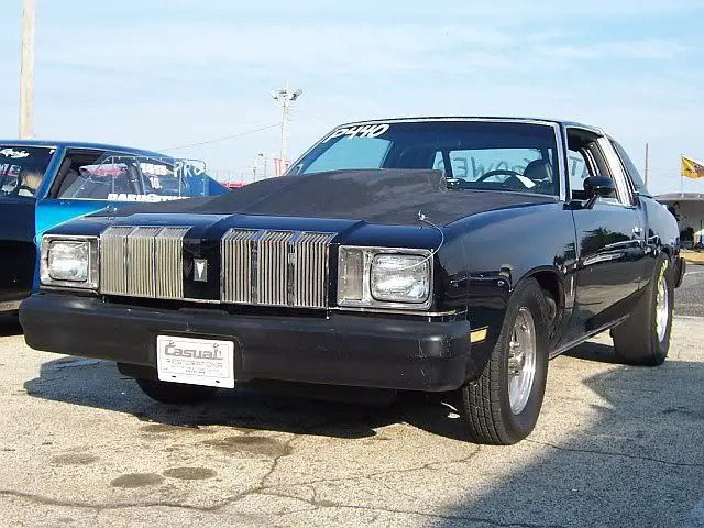

Like some suggestions on set-up.Car is 1978 montecarlo,w/9" moser built rearend,spool,4/11 gears.I have currie uca's,southside lift bars for lowers,moroso trick springs and comp. eng. 3 -way adj. shock on all 4 corners.the rest of the front end is stock.wondering if any one else, is running currie uppers??l'm having trouble setting pinion angle,need more neg. angle,looks like my southsides are the problem,any suggestions on lowers that you guys use that work,the set-up will be factory more than the lift style w/southsides.double adj. lowers or boxed style?Wondering if i could use southside lowers as box style,moving the location from the bracket that comes with those ,to factory location on housing bracket,what else should i be concerned with if i do that??Also would like to lower car,any suggestion on springs?Can i cut the moroso trick springs to achieve desired heigth without sacrificing spring rate??
