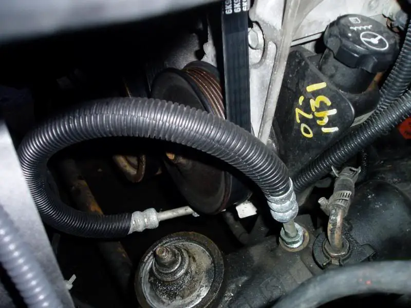

Anyways, the truck PS pump pulley hits the stock SS steering box. The pulley measure 6.75", I'm gonna see if I can locate a smaller diameter one which should fix that problem.
