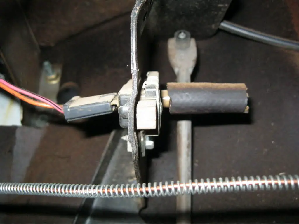

Here's one on the gas pedal arm (not mine - lifted from the 'net):
........same set up I'm using. I'm not sure what is up with that piece of fuel line on the switch's arm??
You do not have to connect the kickdown solenoid for proper transmission function. With it disconnected the transmission may not downshift automatically to provide passing gear at speed, but you may simply manually downshift the transmission if necessary. The transmission will still automatically downshift at low speeds (typically below 40 MPH).
The kickdown solenoid was originally connected to a rheostat built in to the accelerator pedal assembly on original GM TH400 applications. B&M and Lokar both offer aftermarket kickdown switch kits that can be made to work with just about any carb or EFI arrangement.
