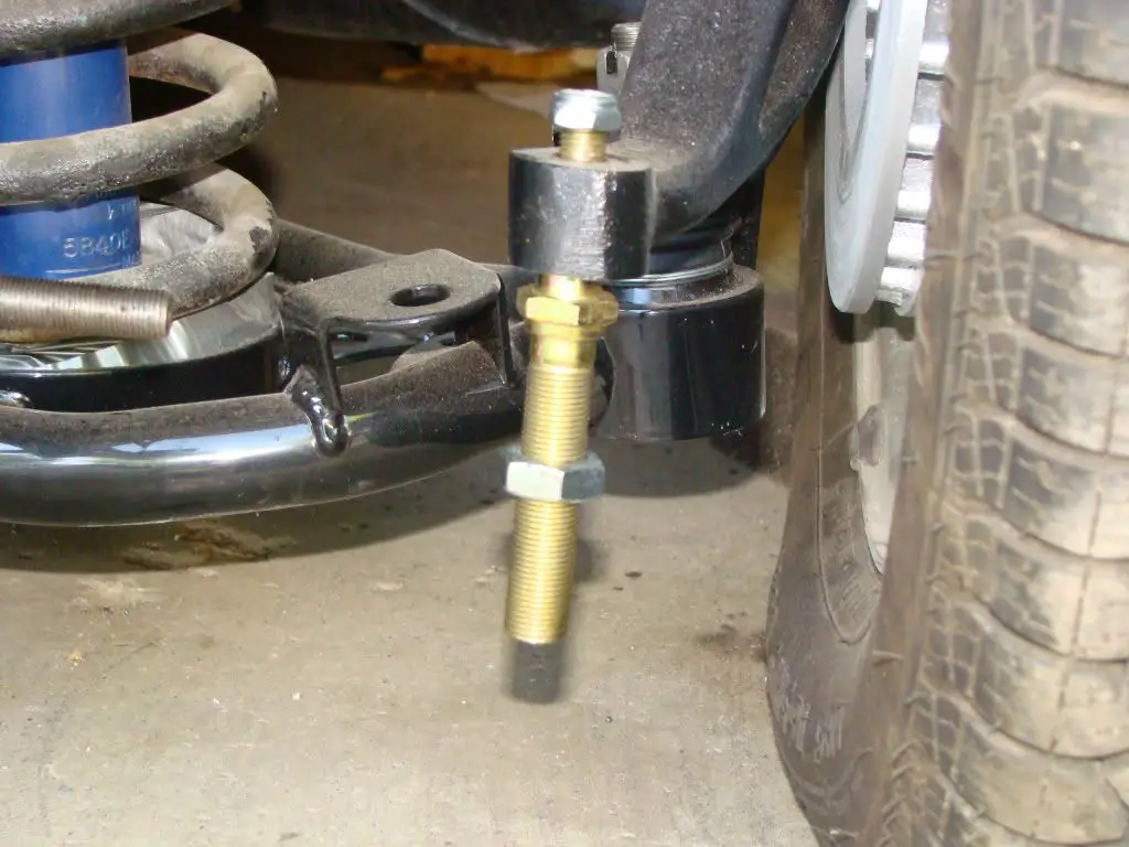

Here what I used... You have to go to a 5/8 joint and then you use a spacers on the top and a double or lock nut on the bottom to ajust your tie rod up or down if you ever change your ride height.
They are a little long so I shorten mine... Plus you don't have to drill your spindles.....
Speedway Motors I think $9.95 each... I now have QA1 spring and shock so they worked good for me.

Now that's a pretty cool peice of hardware!!!
