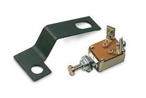

There is no provision for a reverse lamp switch on the Muncie, but a bracket may be available; Tommy used this special bracket.
shvrolay
Re: WHAT DO I NEED TO SWITCH FROM SAGINAW TO MUNCIE. NEED H
Hurst sells this piece to hook up your reverse lights, kind of Barney-Rubblefied, but........it works.

I'm almost certain That you can reuse the Hurst linkage, but you need to get the muncie adapter plate. Is the muncie your using bolts of studs for the linkage rods? Makes a difference. Speedo cable is passenger side in the back on muncies..... I personally used a '68-'70 chevelle Hurst shifter setup and it required only minor trimming of the tunnel from the fsctory location. I did not move the tunnel back as mentioned above, no issues been on the road 2 years. That revearse light switch is what I used, Its not great but does the job. If you intend to drive yours in bad weather you might consider a sealed switch instead

I used the switch for a late 70s to early 80's Corvette Muncie 4 speed. It bolts on with (2) of the side cover bolts & is weatherproofed. I had that other switch once. It was ok, but a pain to set up.
