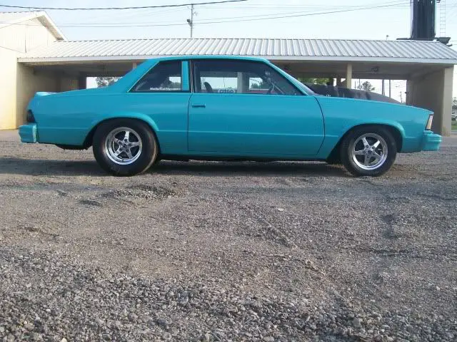

I wish I'd seen this earlier. Hopefully you still check in often or maybe you already got the answer you were looking for. I ran a 15x10 under my car with 28x12.50 ET Streets. I ordered my wheels with 5.5 inch backspace. My frame is notched, and yours will have to be notched to run this size rim. Rolling the lip will also be a necessity, imo. They tuck under the car but it is tight and they do rub going around corners. I did not mini tub my car, but looking back I wish I had and I recommend it. As long as you are notching the frame anyway, you might as well get it over with. I am now running 15x8's with 4.5 inches of backspace with a 28x11.50 ET Street and they tuck even more and no rubbing. I would still recommend the frame notch with this setup, as 4.5 inches of backspace will usually put the tire into the frame on these cars. Here is a pic of my car with the 15x10's under it, this is after I lowered the car as well.

TOMS78BU i need to know need what wheel i need to put a M/t L60 on my bu it has stock rear end and summit says thay can be run on a 7 to 10 in rim and there 28 o.d and tread with is 10 in so i like to run a 10 were i can make use of all the of the tire so a10 with a 5.5 bs will work with a frame notch thas cool but a 8 with a 4.5bs will work thats alright i know i have to run spasers on a 4.5 bs or still do a frame notch so i just want to do it right plus i need to know what 12 bolt i can put under it were i can be looking for 1 and i like to say i love ur bu its so bad s## and i love ur wheels do u know were i can get some like thati know the company was sold but dont know who took it overany help from you will be thakful thanks for your help allan

Yes, if you want to run a 10 inch rim, then 5.5 inch backspace is what you need but that is with a stock width rear end. If you are going to run a 12 bolt it will have to be out of an early Chevelle and it will be wider. In that case, I believe a 6.5 inch backspace will work. If you want some wheels like mine, they are being made by a company called Racestar Industries now. Go to http://www.racestarindustries.com and check it out. Let me know if you have any other questions.
