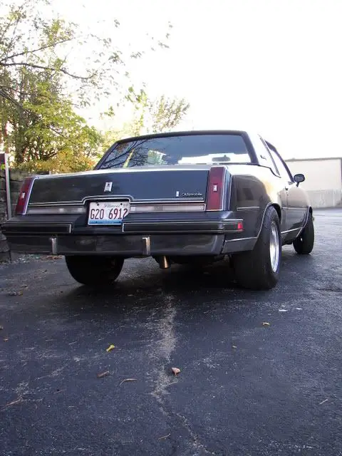

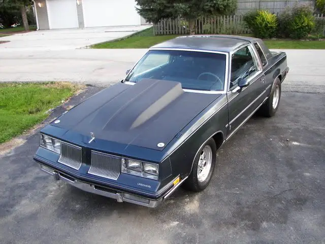

I have 275-60-15's on 10" rims with 4.5" backspacing, on an 86 cutlass.
Olds80Six
Jan 30, 2006
125
Westmont, IL
Yeah it's a stock width housing. No wheel tubs or frame notching, just have the wheel lips rolled.
