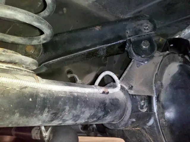

I recently purchased an 81 Malibu from a friend who built it over 20 years ago. It sports a 98 LS1/T56 with a GN 8.5 3.42 rear end. He had it slammed but the problem was the rubbing of the front tires. He has stock back spaced wheels on a B body brake upgrade so it pushes the tires out. When I got it I had to lift the car up with some un cut stock front springs and add a spacer to the rear spring perch to even out the car. When this happened I was able to notice the pinion angle running positive 3-5 degrees. I figured this HAD to be the wheel hop issue.
The first thing I did was to box the upper control arms. That didn't do anything.
Next I made an instant center relocation bracket for the upper control arms. Basically it's a home made version of the anti hop bars without the wrap around the pumpkin lower section. When I did this I was able to rotate the rear end forward to create the 2.5 degrees of negative pinion angle I was looking for. This didn't help.
Today I got smart and finished boxing the what was left of the rear control arms.....you guessed it....didn't help either.
I am at my wits end here. I've owned a few G bodies before and NONE of them ever did anything like this.
Any suggestions would be great. Thanks guys. Alex.
