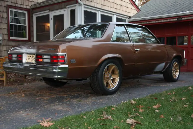

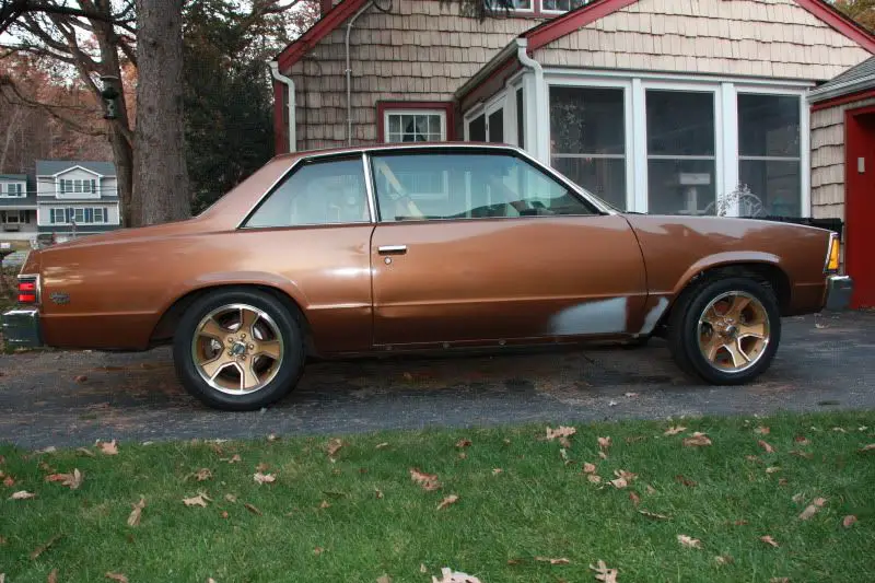

I have 17" x 8" on my car. The rears have 255/50s with 4.5" BS. The fronts have 245/45s with 5" BS because I have the B-body spindle/1LE brake conversion which widens the front track a little.
