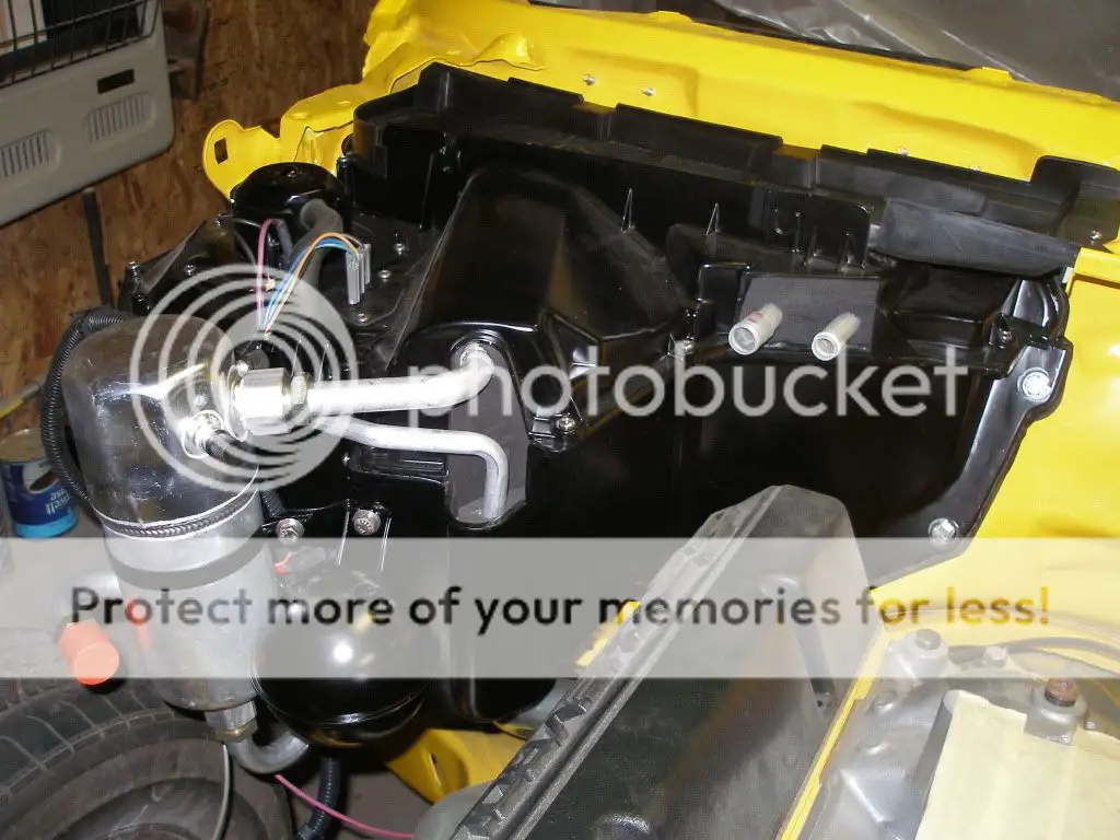

Malibuwagon80 wrote:Anybody got any pics.?
ImageImageImagehere's a drive in speaker i restored and my heater/ac box.its really a nice semi gloss.its just rite if you ask me.i love it.that speaker pic almost looks brown but its only the photo i assure you.i use this stuff all the time,its a good product
