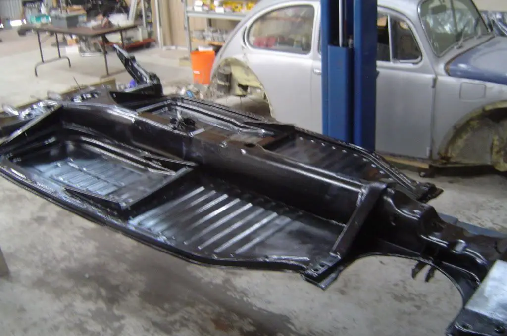

yeah I just could have swore there was more information out there. I'm going to be using the Herculiner bedliner on a majority of what I'm dealing with at the moment..the only part that is going to get actual paint is probably the top of the pan ('71 vw beetle). The bedliner is roll-on and I dont think as picky as a regular thin-paint so I'll probably just do as someone else said and clean/scuff the metal and forget about the primer.

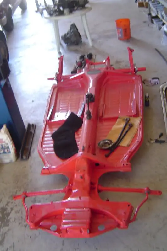

haha thanks, but you're a year too late! I did por-15 on the frame of my beetle and a top coat on top of it. Neither paints are supposed to chip but I definitely got some chipping during install of a couple parts...nothing some touch-up won't fix though.
I'd definitely use the stuff again.
