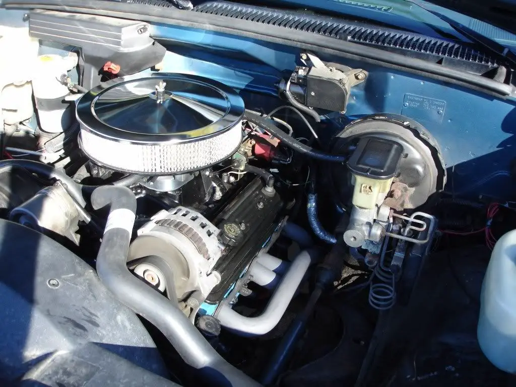

The proportioning block in my '92 Sierra is just under the master cylinder... is that something like what you're talking about?
