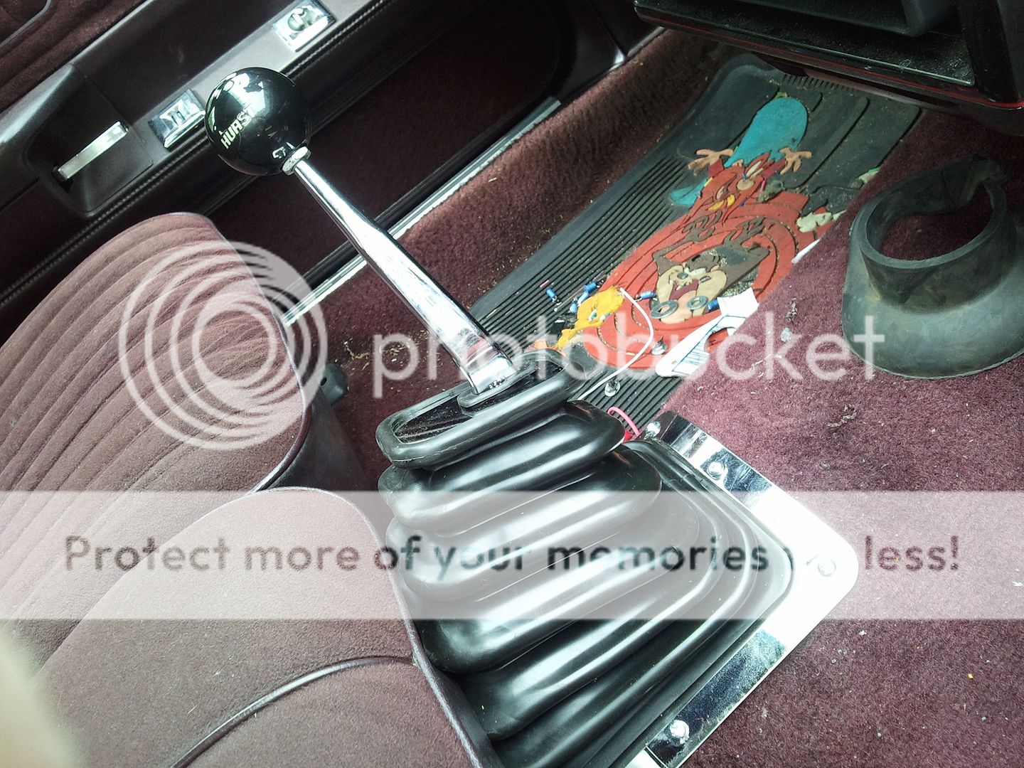

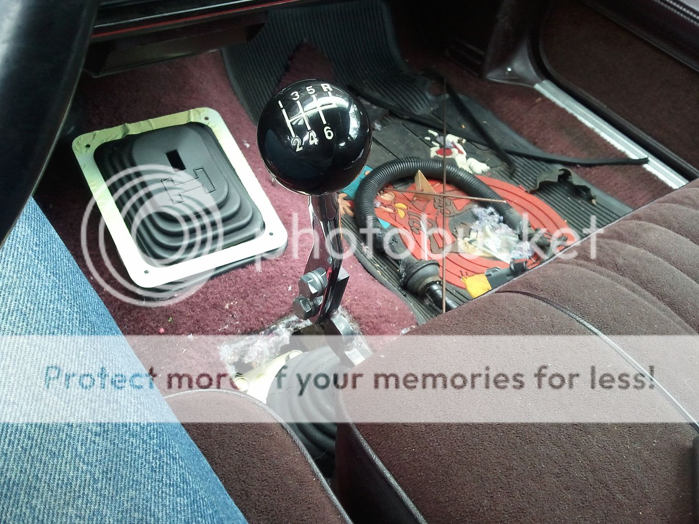

Hi, I had a friend at work make a bracket, then drilled 2-holes and tapped 2-holes. Made Z like extension, came out good. Then put the Super shifter boot over it. Came out pretty good. If you want to see what it looks like I can send them to a email address, the pictures are on my cell phone. Thanks Ray

Post by t5montecarlo » Fri May 11, 2012 5:22 pm
Here ya go! It fits well. Is the passenger seat able to move forward? or must it remain all the way back?

Post by Ray396 » Sat May 12, 2012 6:31 am
The passenger seat can move a little. I have driven it and seems fine so far.Thanks for posting the pictures. Ray
