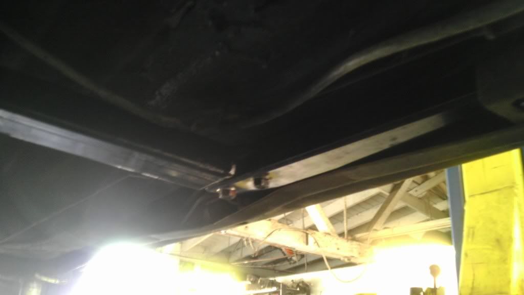

Post by hecx78malibu » Fri Jun 08, 2012 12:47 pm
SSedan64 I finally got the part and installed it. Thanks allot guys. Here are some pics.

Re: th 400 crossmember
Post by SSedan64 » Sat Jun 16, 2012 10:10 am
