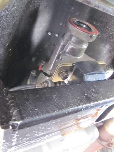

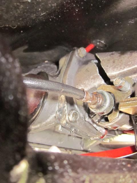

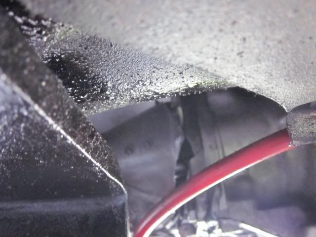

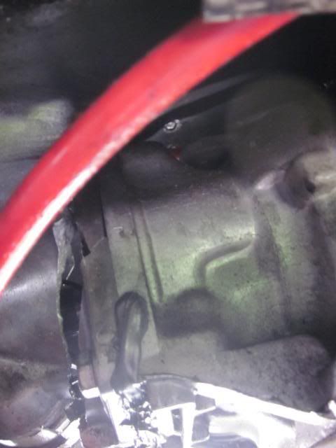

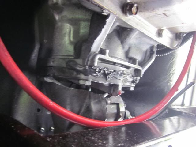

A few weeks ago coming a cruise in I threw my driveshaft on the highway playing around.......a group of various cars behind my headed me locked it down when trans fluid spilled out........what I want to know from others who had this happen how much damage occurred to your tranny? Here is some pics from todays inspection.............broke the tailshaft all the way but the mount stayed intact and the iceman xmember held but the Energy Suspension tailshaft mount was the weakest part which I believed flexed..........
406 sbc, serpentine belt system, 700R4/2500 stall, 3.73 non posi(3.73 posi chunk & 4.10 gears on the bench), 2.5 exhaust, B&M Magnum grip shifter, installed new headliner, and Weld wheels.

Ouch! Did a u-joint seize? If that happened it could have caused major vibration in a short time frame.

The rear u joint caps are gone......the drive shaft rolls across the garage floor smooth.....we were thinking the u joint clamp came loose and beat up the same clamp until loose at that high speed which all happened in less than a minute.....Energy suspension trans mount says Im supposes to have their engine mounts also for 3 way use.....never heard that before.....I had factory motor mounts......about 2.5 years on this set up......

It kinda looks you might have had a cracked tail shaft earlier with the sealent you used. Anyway check your bellhousing area for cracks, I've broke 2. I would also do some reading on driveshaft critical RPM, Precision Shaft Tech has a nice reference chart. This bit me once also. Hope all you need is a new tailshaft housing. Nice car - would like to know how that interior goes.

I would strongly advise that you disassemble the transmission and check the output shaft to make sure it isn't bent. It's also possible to damage the rear planetary carrier when a driveshaft fails.

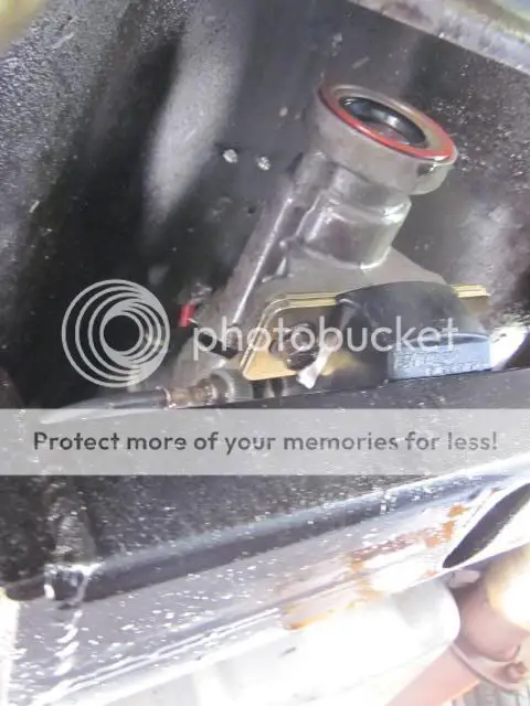

383S10
Posts: 581
Joined: Sun Feb 29, 2004 7:08 pm
Location: Huntsville, AL
Re: Lost drivehsaft at speed, damage ensued.............
Post by 383S10 » Sat Sep 01, 2012 4:17 pm
lilbowtie wrote:It kinda looks you might have had a cracked tail shaft earlier with the sealent you used. Anyway check your bellhousing area for cracks, I've broke 2. I would also do some reading on driveshaft critical RPM, Precision Shaft Tech has a nice reference chart. This bit me once also. Hope all you need is a new tailshaft housing. Nice car - would like to know how that interior goes.
That sealent is where tailhousing and trans case comes together.....I had a drip there after replacing the rubber seal......just a drip at the bottom the sealent was spread on the outside not in joint...........
