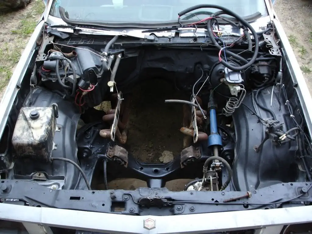

Since I am pulling my engine back out AGAIN, I am going to tak ehte chance to clean up the front of my frame and get some paint on it.
What should I use to clean the frame?
What should I use to paint the frame?
I will be doing this outside, but under a car port. It will probrably be pretty cool out.
I am not rich, so I would really like to keep it as cheap as possible, but I don't want to have to do it over again for at least a year, when I plan to do a full frame off.
