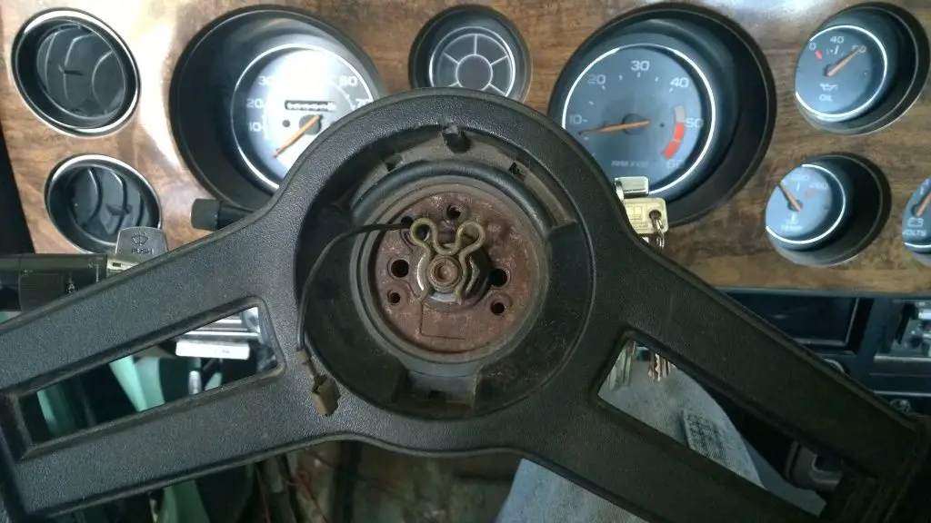

So here's what I have, and I'm having trouble tracking down a picture of the rest of what I would need for the horn button... I seem to remember some sort of little retainer that holds the horn button, but I don't know what it looks like or how to install it.

That horn wire is for the other steering wheel. For the center button horn, the wire is just a stub with a contact that sits just above the surface of the center of the wheel (http://www.elcaminocentral.com/articles/elkysteering/loose_stcolumn/DCP_0747.JPG .

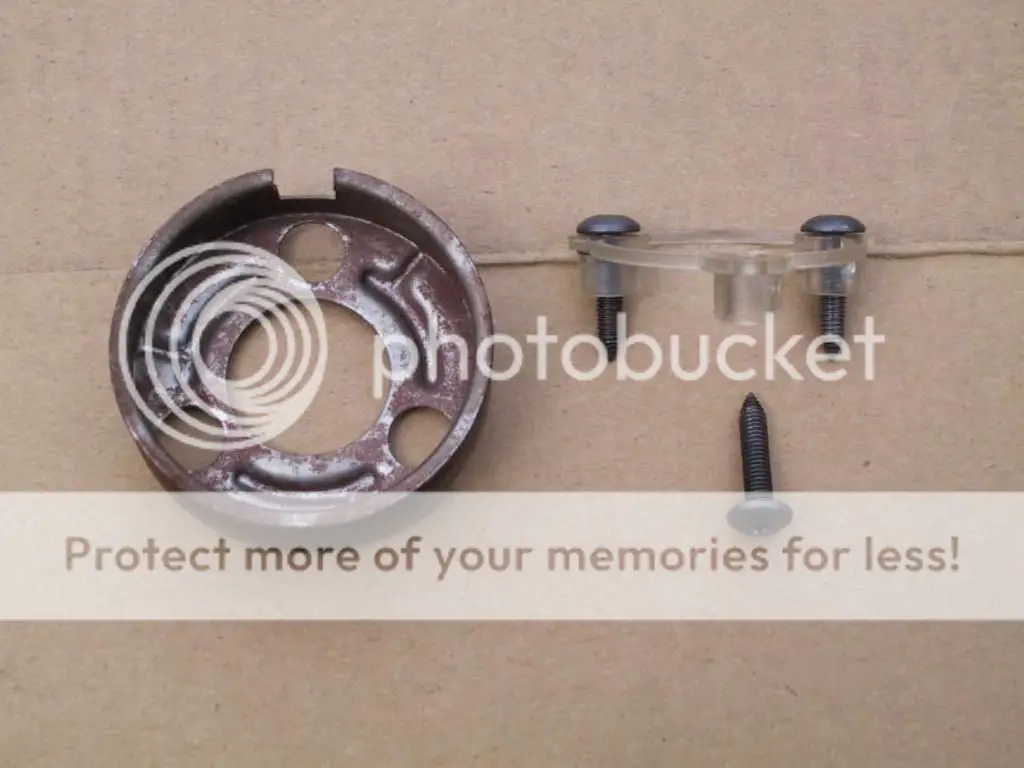

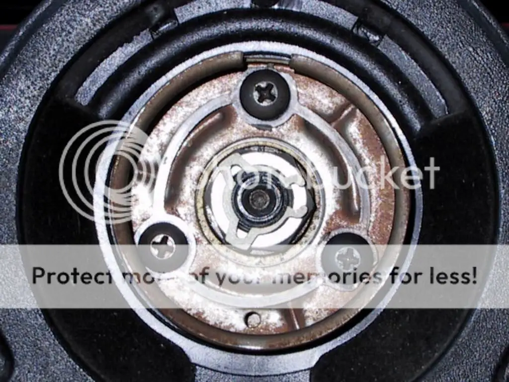

Then the flat round horn spring goes in. Then a metal cup sits on top of the spring and is either held in by the metal screws and the insulator shown in the link or by plastic screws and no insulator (the plastic screws always get loose; don't use those screws). Then a plastic piece (PN 329738) is covered by the vinyl horn button. The plastic piece snaps into the metal cup. Don't forget to add the emblem of your choice into the center of the vinyl horn button.
