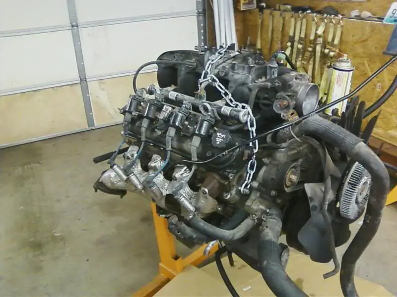

This is the engine when I bought it.

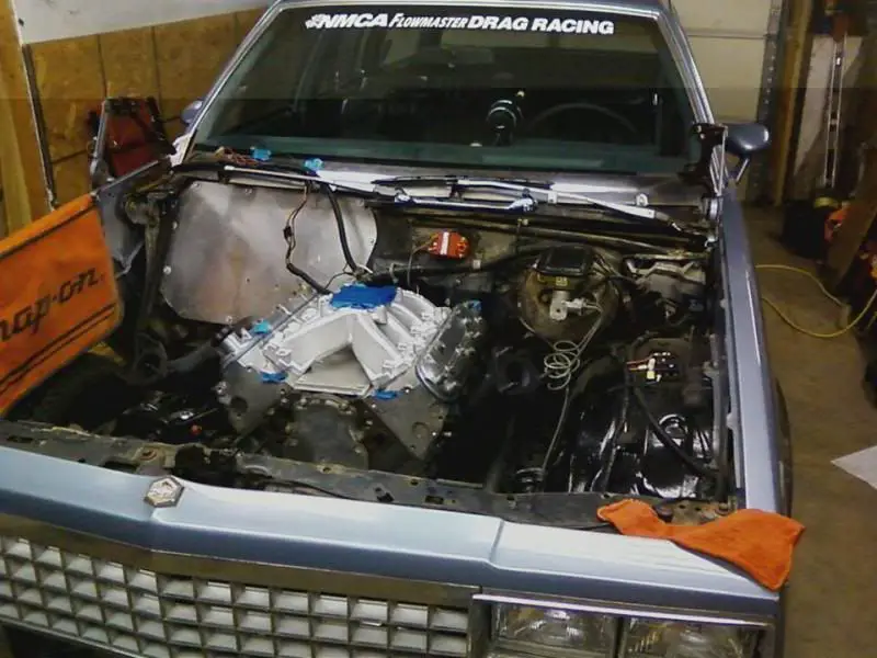

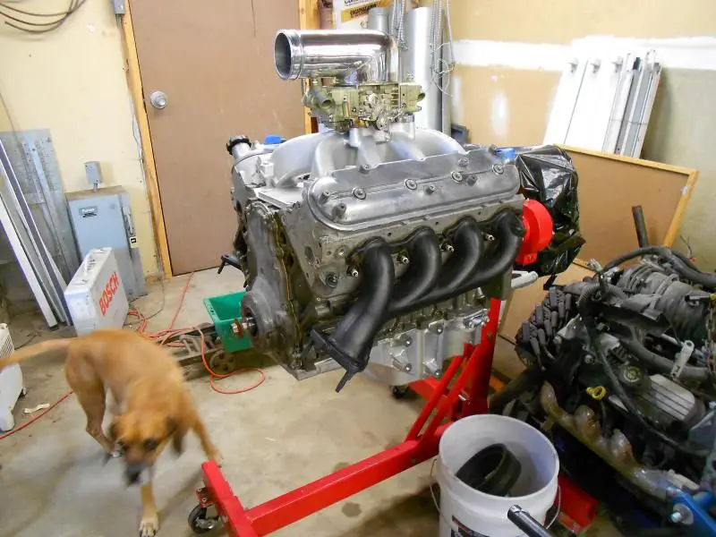

The engine is done. I decided to pass on the truck manifolds for a pair of C6 exhaust manifolds(still going to use the 2 bolt flanges too!) The engine like I said is an 03 LQ4 with 113,000 miles. The bottom end is 100% stock from the pistons down except for the LSA CTS-V oil pan/baffle/pickup. The timing chain is the German IWIS chain with stock gears. The heads are stock as well with Brian Tooley valve springs and Brian Tooley triunion's for the stock rockers. The cam is a Tick Performance Stage 2 custom turbo grind. The intake is a box stock Victor Jr. The carb is a CSU E85 750 blow-thru and the carb hat is also from CSU.

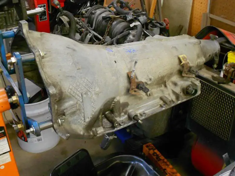

This is the 2003 4L80E transmission I picked up from a local pull-a-part for $100. I have no idea the mileage but it got a bath and a Trans-Go Stage 2 shift kit as soon as it got home. The converter is a Circle D 3500rpm converter.

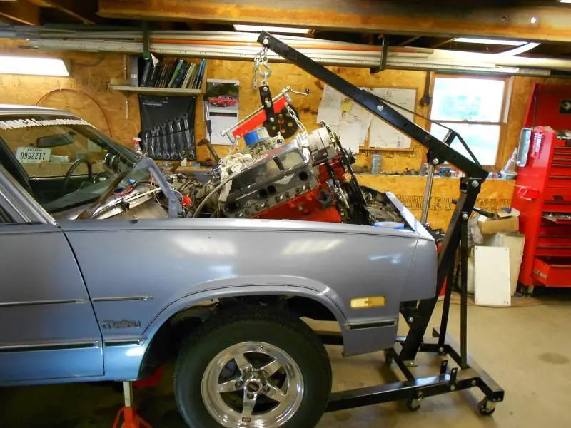

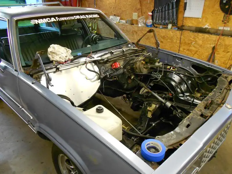

In with the new!!!
6 hours later it's done! It took forever because we had to cut a hole in the K-member for the turbo drain line WITH the engine in place..who does this stuff before hand?lol I used the Dirty Dingo solid slider engine mounts with my old Moroso solid SBC mounts. The engine and the oil pan fit ok but it sits MUCH farther back than the SBC. Like I could fit 2 credit cards between the passenger side cylinder head and the firewall...weight transfer!!

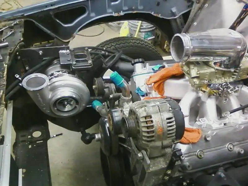

The turbo is a Borg Warner S475..96mm turbine wheel..1.32 A/R. The mount pictured has changed but the turbo is still in the location shown. The plan is run an 11 gauge aluminum downpipe in front of the front passenger tire. I just finished mounting a Lincoln Mark III fan on my old Griffin radiator so I'll post some updated pix later. The car is going to go to Fathouse Fabrications for the hotside/coldside and downpipe. The goal is to make over 650RWHP and get a 9 second pass. Stay tuned!! Later on, Nick.
