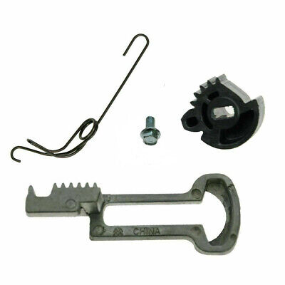

There’s the tilt wheel steering column and the bottom picture is the piece that’s broke that won’t allow it to start with the key. The top picture shows the red trim piece they busted up I assume attempting to Hotwire it? Everyone said good luck finding another one of those in any color for a stick shift car. I remember my dad bought an entire column off of eBay right after this all happened and I think he’s still got it in a box in his basement. I remember it was blue though and I have no clue of it was for a column shift car or not. I’ll have to ask him. I was re reading this thread and in one of my earlier posts I got my words jumbled up. The saginaw in the car and the super t10 both have two RINGS on the input shaft. For some reason I said splines.

That specific lower shroud was only used on an AMC Spirit or an S-10. Various length shorter versions were used in other applications (pickups, Chevette, 3rd gen F body, Jeep, etc.) and you may not notice the difference since in the Chevrolet, most of the shroud is well under the dash, even at the bottom.
Here is a link to an article I wrote over 20 years ago, about the knowledge I had 10 years earlier. At the left is a link to Steering Column, which may provide you with some information.
I can't quite tell what is hanging out of the side where the shroud was destroyed.

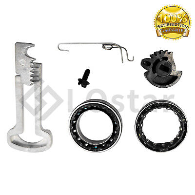

The broken rack you have in your hand is available, but only as a kit. The GM part number for the kit is 7844651. It appears to be the same kit as sold under a Jeep PN 83510055. GM and Jeep both used Saginaw steering columns, so there is a lot of interchangeability of parts.
On the left side of the column, was the pushrod that engages with the ignition switch also bent/damaged? That pushrod will engage with the piece of the rack (in your hand) that is missing.
There will be 2 rods: 1 for the dimmer switch and 1 for the ignition switch.
It has been a while since I had a column apart, but I think the curved rod that is visible is for the dimmer switch.
I am not sure I see the rod that engages with the rack, that connects to the ignition switch (attached to the column next to the dimmer switch).

Dang you know your stuff. It’s all there. My brother popped out an old steering column tool kit and knew what ever little piece was for. Had it apart in 5-6 minutes. The rack kit is ordered. Also, he showed me the original locking mechanism in the tailgates of these cars were made by Briggs and Stratton? Is that true? He said to ask around because he found a NOS one for sale
