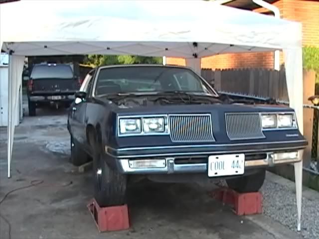

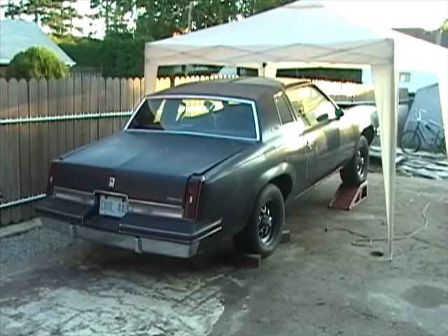

heres a couple shots of the car.

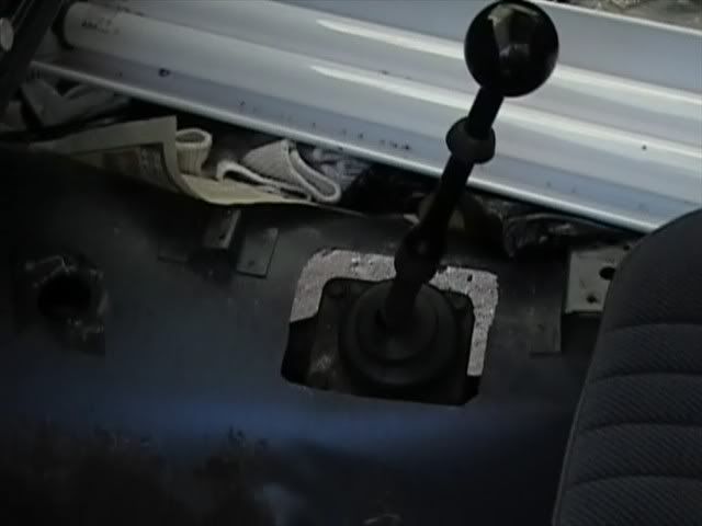

here is the shifter... i probably will cut/weld the shifter rod to fit it into my console.

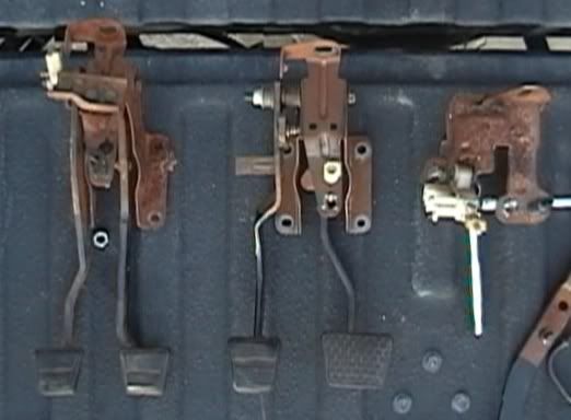

here is a shot of mech pedals (left) and 3rd gen pedals in mech bracket (center) and 3rd gen bracket (right)
i can make the 3rd gen pedals AND bracket work with a lot of mods... if i need to to have hydraulic linkage.

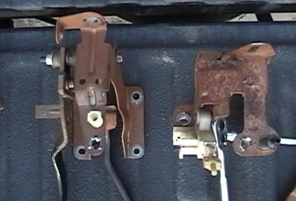

here is a close up of 3rd gen pedals in a mech bracket (left) and 3rd gen bracket (right)

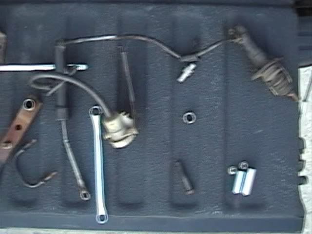

here are my other parts for this swap... is the master push rod suppose to be bend lilke this?

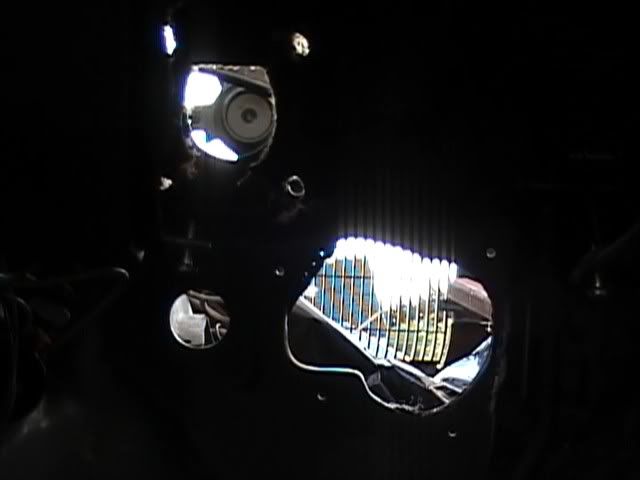

here is my firewall... factory cruise control hole too. it's dark i'll get a better one.

I never considered putting the F body pedals in the G body bracket. It looks like it works out well.
The problem I have noticed with F body pedals installed is that they seemed to be a bit high, but perhaps that is not an issue if they are installed in the G body bracket.
By the way, the bracket is the same for both automatic and manual transmission. The stop for the clutch pedal is a bolt-on part.
