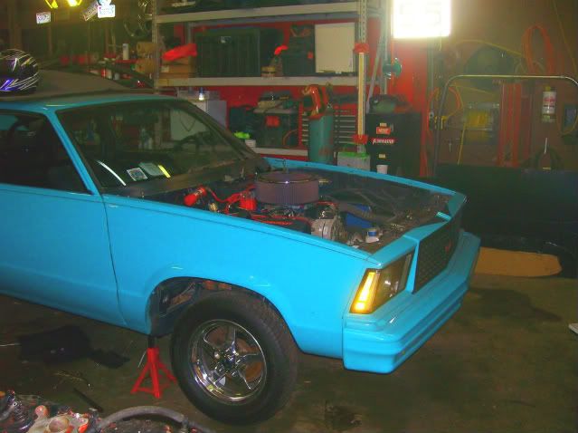

As has been discussed, there have been those whose Greg Welds would not clear the dust cap on the rotor due to the center cap height on the wheel. I waited for them to release a new center cap, but got tired of waiting and bought my front wheels anyway. Well, I had no such trouble with mine. The dust cap doesn't even touch the center cap. Here is a pic of them mounted on the front of my car. They look dull because I took these pics tonight and I had to lighten the pics to be able to see them. New rotors will be installed soon and I think I will get some of that Duplicolor brush-on caliper paint. I like them, and they were only $125 each. They are 15x3.5 and the tires are 165r15 volkswagen tires.

One possible explanation is that there were 3 different spindles used on the 1978-1988 Malibu. 1978 was unique and had a unique brake rotor. Then in 1979, there was a 1st design and then a 2nd design. The 2nd design is the same used until 1988. I don't know exactly what the difference is, but I would guess that the outer bearing on the 1978 spindle is closer inboard than on the later spindles.

that settles it...those rims were made specifically for these cars, no question about it. sweet tom!!!
