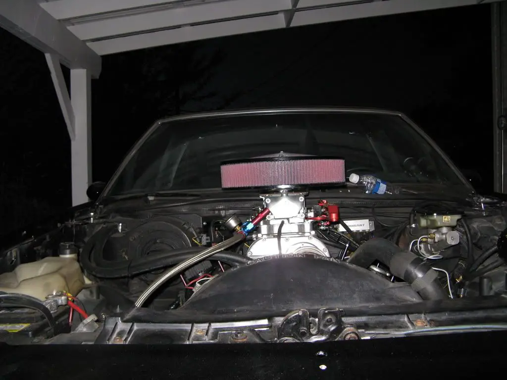

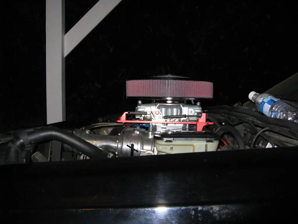

I have the 142 in my 78 Malibu and it barely fits under a 2-1/2" cowl hood even after playing plenty of air cleaner games. The Monte might have a smidge more hood clearance to start with than my Malibu, but expect no miracles.
They call them "underhood blowers" but in reality they are "under big cowl induction hood blowers." Maybe you could fit them under the stock hood of, say, a 55 Chevy, but nothing from the modern age.
