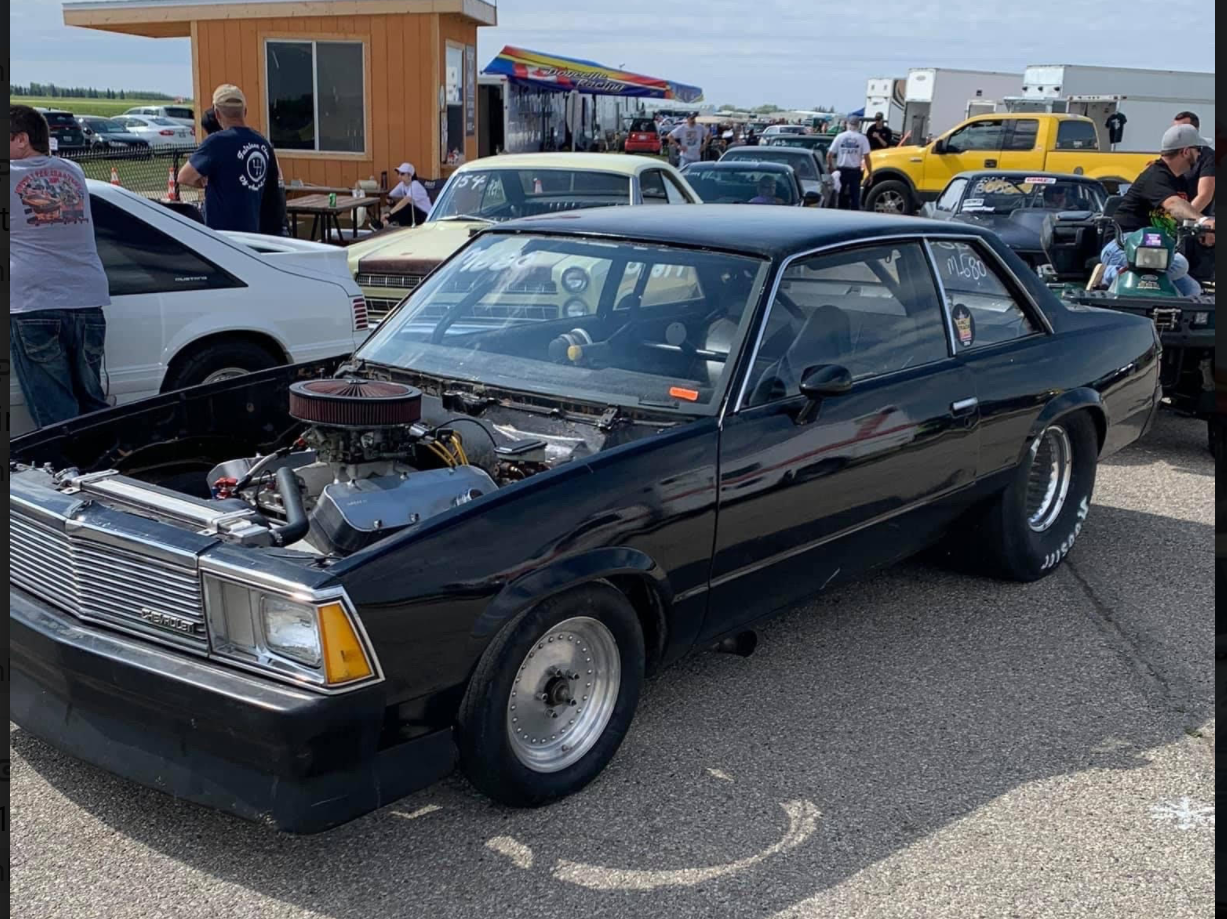

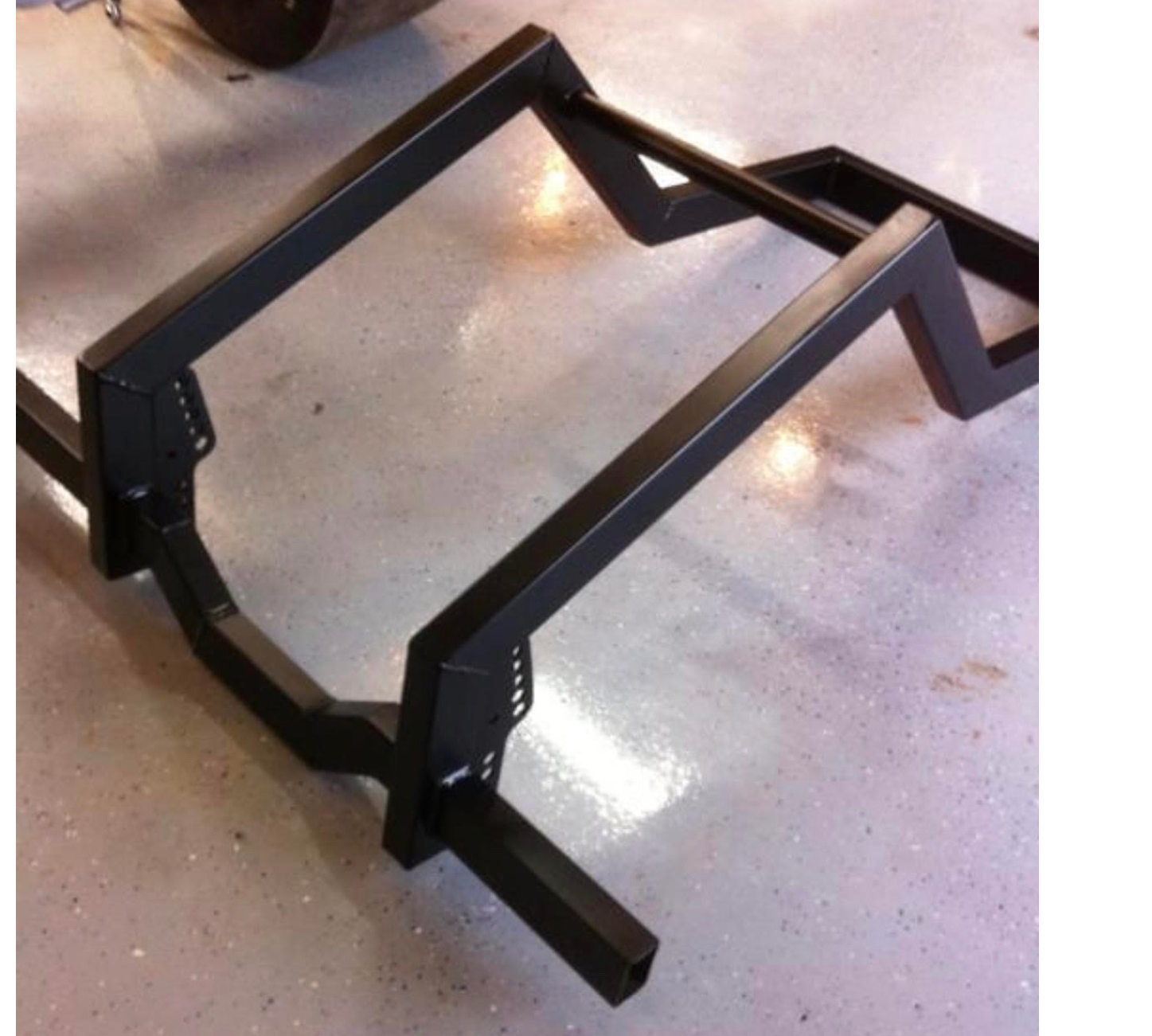

My Malibu is currently certified to 8.50 with a 2x3 4 link back half, is it possible to certify to 25.3 spec ?
or am I limited to 25.5 certification? I building a 540 procharged combo so trying to decide what power level i will end up with and if I am limited on how far I can update this chassis

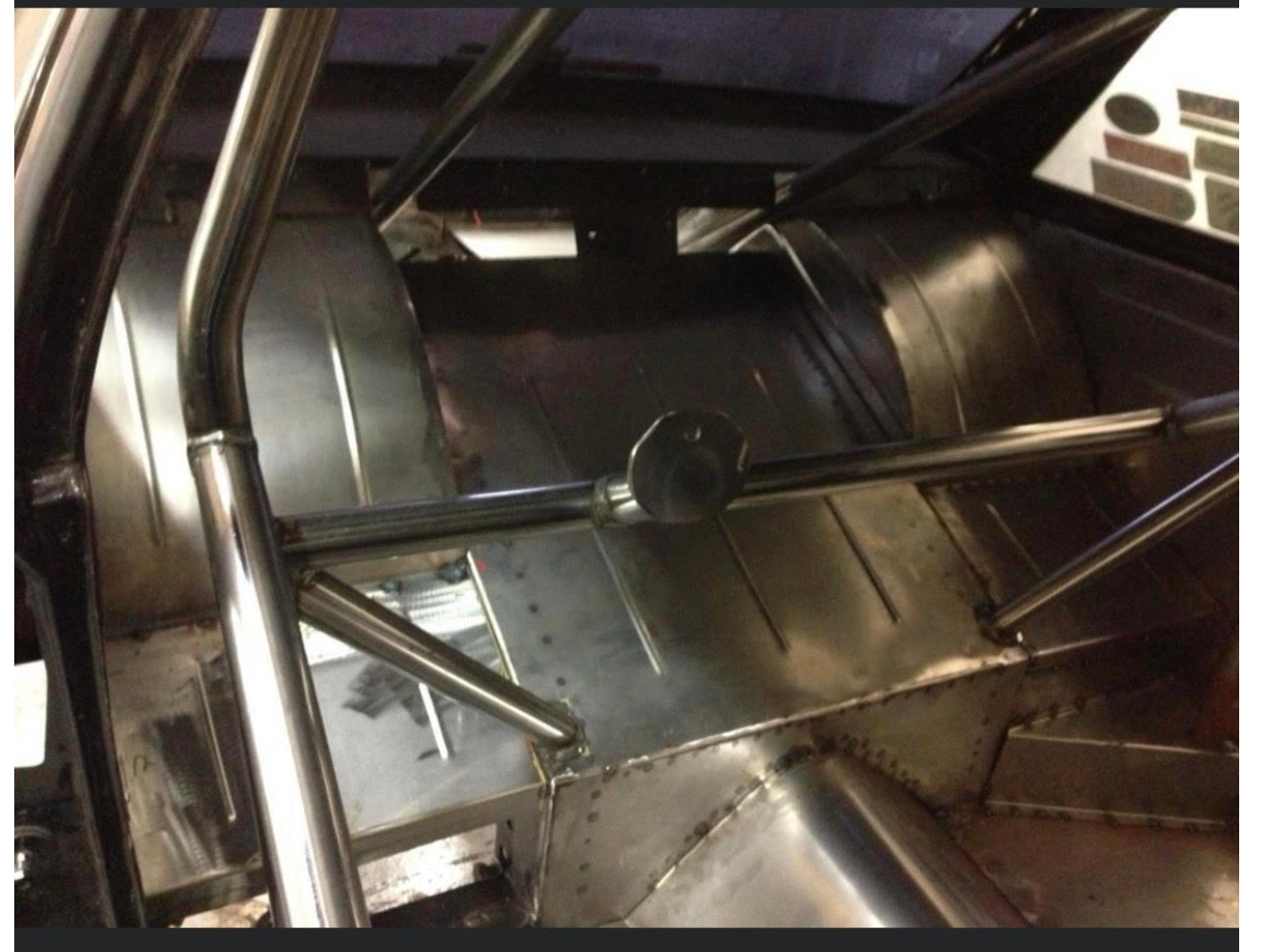

I am willing to replace the entire cage with CM bars but am unsure if I will cert with the backhalf.
help from anyone would be greatly appreciated
here is the current setup - NA 540

I'm sure the back half will cert if the cage is CM AND has to be TIG welded only. Not the back half but the cage. I just got a 25.3 done and difference between 8.30 and 7.50 is had to be CM and tig welded
