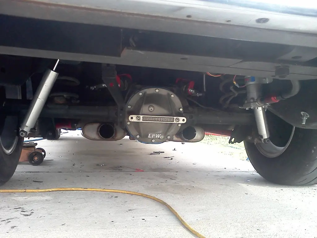

junk racing
sorry its been awile heres the pic, i need to go measure the width right quick, notice in the pic i spun the axle tubes, gotta pull it out and have it fixed
